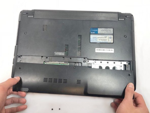

    • Turn laptop over to expose the bottom panel
  2. Asus A53E-ES92 Wifi Card Replacement: crwdns2935265:02crwdnd2935265:01crwdnd2935265:02crwdne2935265:0 Asus A53E-ES92 Wifi Card Replacement: crwdns2935265:02crwdnd2935265:02crwdnd2935265:02crwdne2935265:0
    • Use a Phillips #0 screwdriver to remove the two screws circled in picture.
  3. Asus A53E-ES92 Wifi Card Replacement: crwdns2935265:03crwdnd2935265:01crwdnd2935265:03crwdne2935265:0 Asus A53E-ES92 Wifi Card Replacement: crwdns2935265:03crwdnd2935265:02crwdnd2935265:03crwdne2935265:0 Asus A53E-ES92 Wifi Card Replacement: crwdns2935265:03crwdnd2935265:03crwdnd2935265:03crwdne2935265:0

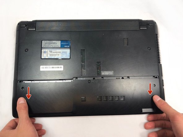

    • Place fingers on panel as shown below.
    • Apply slight force while gently sliding the panel away from the laptop.
    • Remove panel.

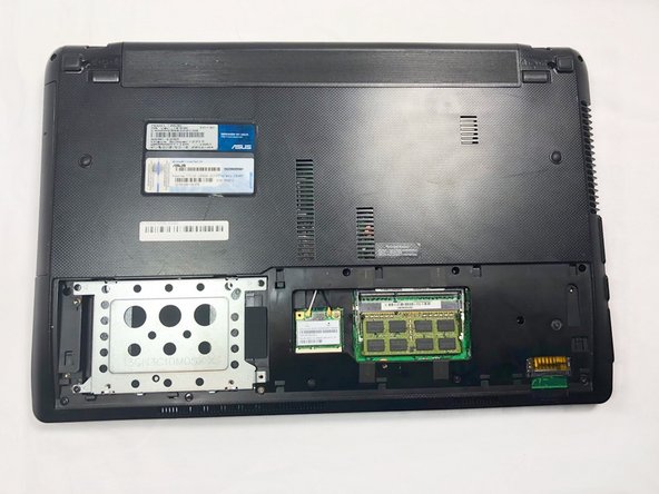

    • Locate wifi card, circled in red.
  5. Asus A53E-ES92 Wifi Card Replacement: crwdns2935265:05crwdnd2935265:01crwdnd2935265:02crwdne2935265:0 Asus A53E-ES92 Wifi Card Replacement: crwdns2935265:05crwdnd2935265:02crwdnd2935265:02crwdne2935265:0

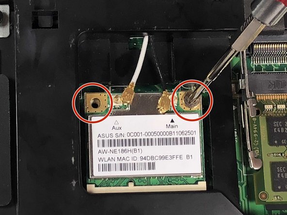

    • Remove the two screws using the Phillips #0 screwdriver.
  6. Asus A53E-ES92 Wifi Card Replacement: crwdns2935265:06crwdnd2935265:01crwdnd2935265:02crwdne2935265:0 Asus A53E-ES92 Wifi Card Replacement: crwdns2935265:06crwdnd2935265:02crwdnd2935265:02crwdne2935265:0
    • Remove the two pin connectors from the wifi card.
