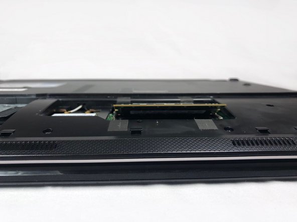

    • Turn laptop over to expose the bottom panel.

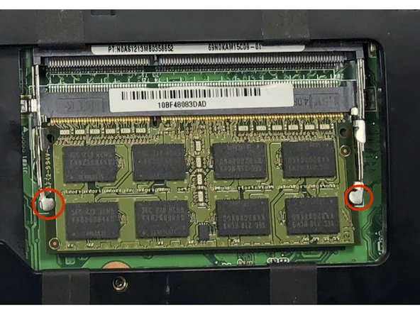

  2. Asus A53E-ES92 RAM Card Replacement: crwdns2935265:02crwdnd2935265:01crwdnd2935265:02crwdne2935265:0 Asus A53E-ES92 RAM Card Replacement: crwdns2935265:02crwdnd2935265:02crwdnd2935265:02crwdne2935265:0
    • Use the Phillips #0 screwdriver to remove the two screws circled in picture.

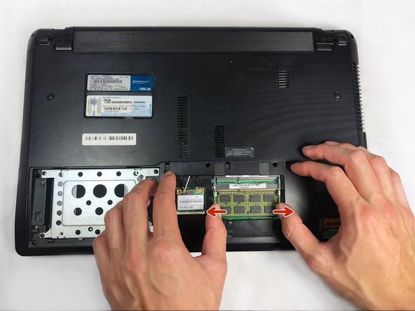

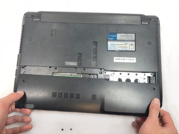

  3. Asus A53E-ES92 RAM Card Replacement: crwdns2935265:03crwdnd2935265:01crwdnd2935265:03crwdne2935265:0 Asus A53E-ES92 RAM Card Replacement: crwdns2935265:03crwdnd2935265:02crwdnd2935265:03crwdne2935265:0 Asus A53E-ES92 RAM Card Replacement: crwdns2935265:03crwdnd2935265:03crwdnd2935265:03crwdne2935265:0
    • Place fingers on panel as shown below.
    • Apply slight force while gently sliding the panel away from the laptop.
    • Remove panel.

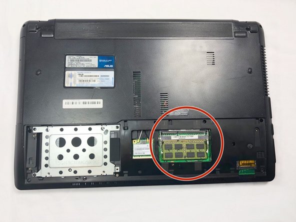

  4. Asus A53E-ES92 RAM Card Replacement: crwdns2935265:04crwdnd2935265:01crwdnd2935265:02crwdne2935265:0 Asus A53E-ES92 RAM Card Replacement: crwdns2935265:04crwdnd2935265:02crwdnd2935265:02crwdne2935265:0
    • Locate RAM card, circled adjacently.
  5. Asus A53E-ES92 RAM Card Replacement: crwdns2935265:05crwdnd2935265:01crwdnd2935265:03crwdne2935265:0 Asus A53E-ES92 RAM Card Replacement: crwdns2935265:05crwdnd2935265:02crwdnd2935265:03crwdne2935265:0 Asus A53E-ES92 RAM Card Replacement: crwdns2935265:05crwdnd2935265:03crwdnd2935265:03crwdne2935265:0
    • Place fingers on prongs located adjacent.
    • Press on prongs simultaneously.

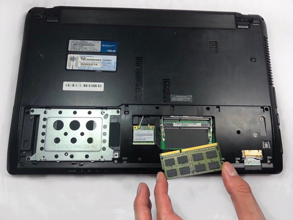

  6. Asus A53E-ES92 RAM Card Replacement: crwdns2935265:06crwdnd2935265:01crwdnd2935265:03crwdne2935265:0 Asus A53E-ES92 RAM Card Replacement: crwdns2935265:06crwdnd2935265:02crwdnd2935265:03crwdne2935265:0 Asus A53E-ES92 RAM Card Replacement: crwdns2935265:06crwdnd2935265:03crwdnd2935265:03crwdne2935265:0
    • RAM card should pop out.
    • Remove RAM card.
