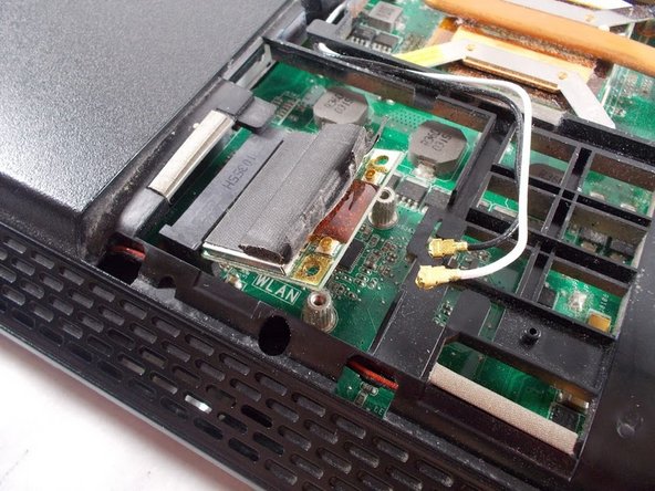

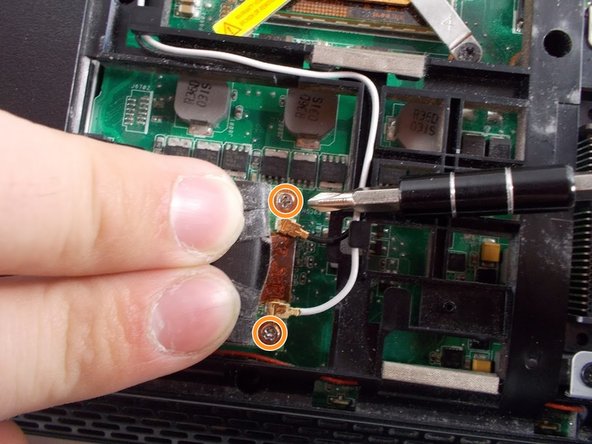

  5. Asus A52F Wifi Card Replacement, Wifi Card: crwdns2935265:05crwdnd2935265:01crwdnd2935265:02crwdne2935265:0 Asus A52F Wifi Card Replacement, Wifi Card: crwdns2935265:05crwdnd2935265:02crwdnd2935265:02crwdne2935265:0
    • First, find the Wi-Fi card
    • Move the protective flap back and use a Phillips size 0 screw driver to remove the two screws.
  6. Asus A52F Wifi Card Replacement: crwdns2935265:06crwdnd2935265:01crwdnd2935265:03crwdne2935265:0 Asus A52F Wifi Card Replacement: crwdns2935265:06crwdnd2935265:02crwdnd2935265:03crwdne2935265:0 Asus A52F Wifi Card Replacement: crwdns2935265:06crwdnd2935265:03crwdnd2935265:03crwdne2935265:0

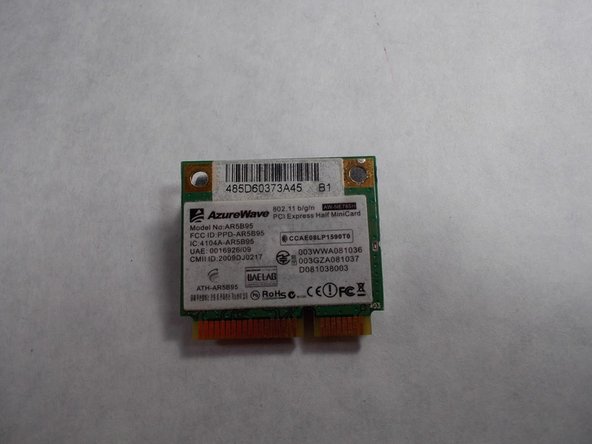

    • First remove both of the wires from the WiFi card.
    • Lift the WiFi card up and remove it.
