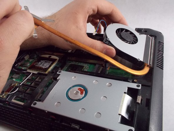

  5. Asus A52F Cooling System Replacement, Cooling System: crwdns2935265:05crwdnd2935265:01crwdnd2935265:02crwdne2935265:0 Asus A52F Cooling System Replacement, Cooling System: crwdns2935265:05crwdnd2935265:02crwdnd2935265:02crwdne2935265:0
    • Removal of cooling system will void your warranty. Proceed with caution.
  6. Asus A52F Cooling System Replacement: crwdns2935265:06crwdnd2935265:01crwdnd2935265:02crwdne2935265:0 Asus A52F Cooling System Replacement: crwdns2935265:06crwdnd2935265:02crwdnd2935265:02crwdne2935265:0
    • Using a Phillips #0 screwdriver, remove all six screws from the cooling system.
    • Unplug the fan power connector.
  7. Asus A52F Cooling System Replacement: crwdns2935265:07crwdnd2935265:01crwdnd2935265:02crwdne2935265:0 Asus A52F Cooling System Replacement: crwdns2935265:07crwdnd2935265:02crwdnd2935265:02crwdne2935265:0
    • Carefully grab the copper pipe and start to lift upward.
    • Lift to the angle shown and then start to slide it out.
  8. Asus A52F Cooling System Replacement: crwdns2935265:08crwdnd2935265:01crwdnd2935265:01crwdne2935265:0
    • Clean the designated area with isopropyl alcohol on a microfiber cloth
    • Replace with new thermal paste if needed
