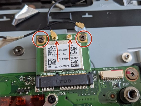

    • Remove the antenna cables from the Wi-Fi Module.
    • Remove the 2 screws to unfasten the Wi-Fi Module, then angle it upwards and pull it out, away from the socket to continue disassembly.
