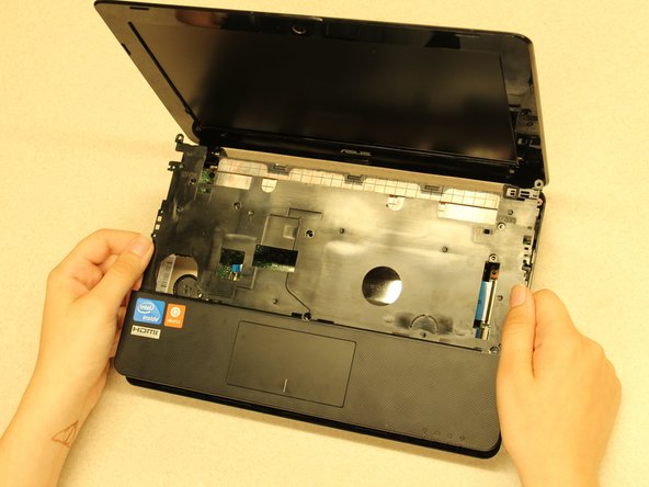

    • Before the baseboard can be fully removed from the laptop, you need to detach the small blue tab attached to the motherboard.
    • Gently lift up on the black plastic tab that is securing the blue tab in place.
    • Carefully pull the blue tab out of the dock.
  12. Asus 1015E-DS03 Trackpad Replacement: crwdns2935265:012crwdnd2935265:01crwdnd2935265:02crwdne2935265:0 Asus 1015E-DS03 Trackpad Replacement: crwdns2935265:012crwdnd2935265:02crwdnd2935265:02crwdne2935265:0
    • Use the spudger from the laptop to 'pop' open the track-pad base, starting from the corner shown
    • Once the corner is popped it may be easier to use your fingers to pop off the entire track-pad base
    • You will hear popping. Although this is normal, use caution pulling the track-pad base from the rest of the laptop

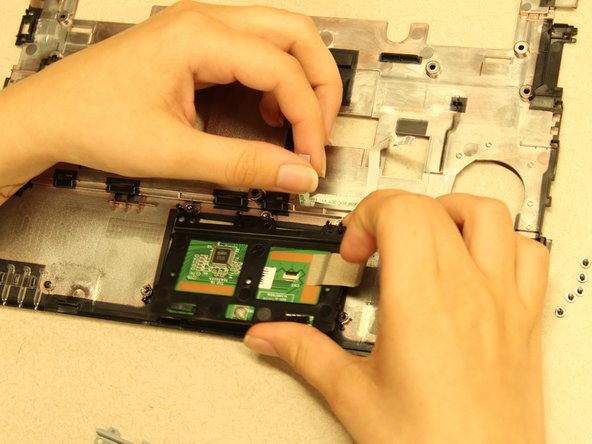

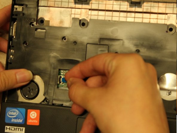

    • Once the trackpad base is detached, flip it face-down.
    • Lift the small black tab that the blue flat cable is attached to.
  14. Asus 1015E-DS03 Trackpad Replacement: crwdns2935265:014crwdnd2935265:01crwdnd2935265:01crwdne2935265:0
    • Remove the 3mm screws (3) circled in red with a #0 Phillips head screwdriver.
    • The metal plate shown in blue will fall off by itself, replace it before re-securing the baseplate.

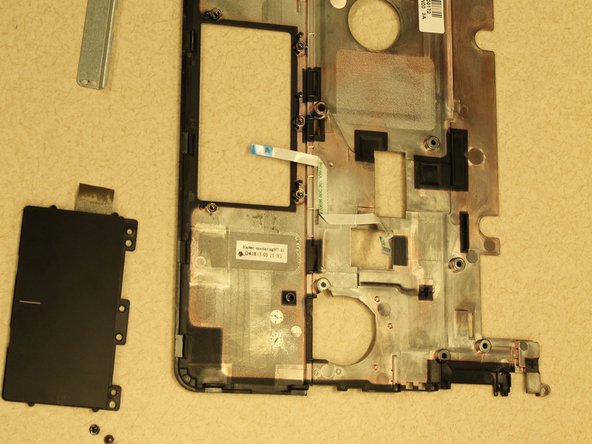

  15. Asus 1015E-DS03 Trackpad Replacement: crwdns2935265:015crwdnd2935265:01crwdnd2935265:03crwdne2935265:0 Asus 1015E-DS03 Trackpad Replacement: crwdns2935265:015crwdnd2935265:02crwdnd2935265:03crwdne2935265:0 Asus 1015E-DS03 Trackpad Replacement: crwdns2935265:015crwdnd2935265:03crwdnd2935265:03crwdne2935265:0
    • Detach the tape connecting the trackpad to the trackpad base, and carefully remove the trackpad.
