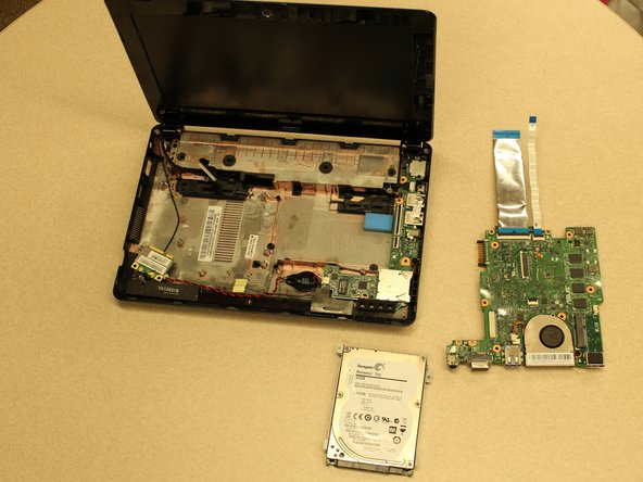

  10. Asus 1015E-DS03 Motherboard Replacement, Motherboard: crwdns2935265:010crwdnd2935265:01crwdnd2935265:01crwdne2935265:0
    • Remove the 3mm screws (8) from the motherboard using a #0 Phillips head screwdriver.
    • Carefully and slowly lift the motherboard out of the base of the laptop.
    • In the picture shown, the hard drive has already been removed, although, it is not necessary to remove the hard drive in order to remove the motherboard. Simply disconnect the two ZIF connectors from the hard drive that are labeled "IO" as shown in the picture and leave the hard drive in place.

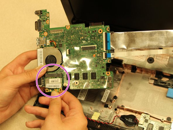

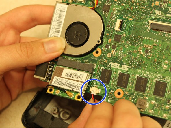

  11. Asus 1015E-DS03 Motherboard Replacement: crwdns2935265:011crwdnd2935265:01crwdnd2935265:03crwdne2935265:0 Asus 1015E-DS03 Motherboard Replacement: crwdns2935265:011crwdnd2935265:02crwdnd2935265:03crwdne2935265:0 Asus 1015E-DS03 Motherboard Replacement: crwdns2935265:011crwdnd2935265:03crwdnd2935265:03crwdne2935265:0
    • Detach the 3 components (2 wires and 1 chip) prior to completely removing the motherboard.
    • Gently pull on the wire until it comes loose.
    • The wire will offer resistance, but firmly, yet gently, pulling on the wire will release it from its dock.
    • Gently pull the chip out of its dock.
  12. Asus 1015E-DS03 Motherboard Replacement: crwdns2935265:012crwdnd2935265:01crwdnd2935265:02crwdne2935265:0 Asus 1015E-DS03 Motherboard Replacement: crwdns2935265:012crwdnd2935265:02crwdnd2935265:02crwdne2935265:0
    • Gently pull out the final cord.
    • When the wires and chip have been successfully detached from the motherboard, your laptop (and the removed pieces) should resemble the picture.
