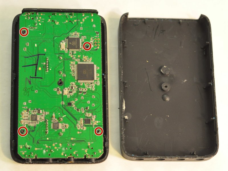

    1. Astro Mixamp Motherboard Replacement, Motherboard: crwdns2935265:06crwdnd2935265:01crwdnd2935265:03crwdne2935265:0 Astro Mixamp Motherboard Replacement, Motherboard: crwdns2935265:06crwdnd2935265:02crwdnd2935265:03crwdne2935265:0 Astro Mixamp Motherboard Replacement, Motherboard: crwdns2935265:06crwdnd2935265:03crwdnd2935265:03crwdne2935265:0
      • Remove the four screws that hold the motherboard in place.
      • Only touch the edges of the motherboard. Touching the surface can damage the motherboard.
    2. Astro Mixamp Motherboard Replacement: crwdns2935265:07crwdnd2935265:01crwdnd2935265:01crwdne2935265:0
      • Gently pull the motherboard from the front cover.
