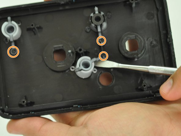

    1. Astro Mixamp Control Button Replacement, Control Button: crwdns2935265:08crwdnd2935265:01crwdnd2935265:02crwdne2935265:0 Astro Mixamp Control Button Replacement, Control Button: crwdns2935265:08crwdnd2935265:02crwdnd2935265:02crwdne2935265:0
      • Gently insert a metal spudger under a control button housing.
      • Do not pry the button housing from the front panel, this can cause damage to the button.
      • Rotate the control button around the marked pin.
