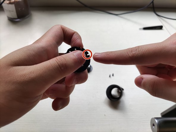

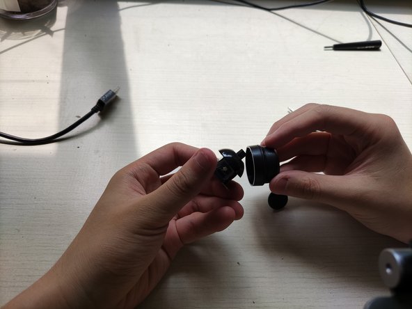

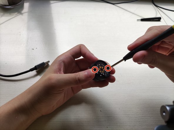

  3. Astro C40 TR Joystick Replacement: crwdns2935265:03crwdnd2935265:01crwdnd2935265:03crwdne2935265:0 Astro C40 TR Joystick Replacement: crwdns2935265:03crwdnd2935265:02crwdnd2935265:03crwdne2935265:0 Astro C40 TR Joystick Replacement: crwdns2935265:03crwdnd2935265:03crwdnd2935265:03crwdne2935265:0
    • Use the 30mm TORX Screwdriver to remove the screws from the module.
    • Push on the top frame until it pops off of the module.
    • If you have a whole new joystick module, you can skip to step 6.

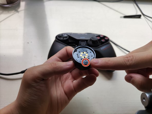

  4. Astro C40 TR Joystick Replacement: crwdns2935265:04crwdnd2935265:01crwdnd2935265:03crwdne2935265:0 Astro C40 TR Joystick Replacement: crwdns2935265:04crwdnd2935265:02crwdnd2935265:03crwdne2935265:0 Astro C40 TR Joystick Replacement: crwdns2935265:04crwdnd2935265:03crwdnd2935265:03crwdne2935265:0
    • Connect the base frame replacement to the joystick module.
    • Insert the top frame on the module until it clicks back together.

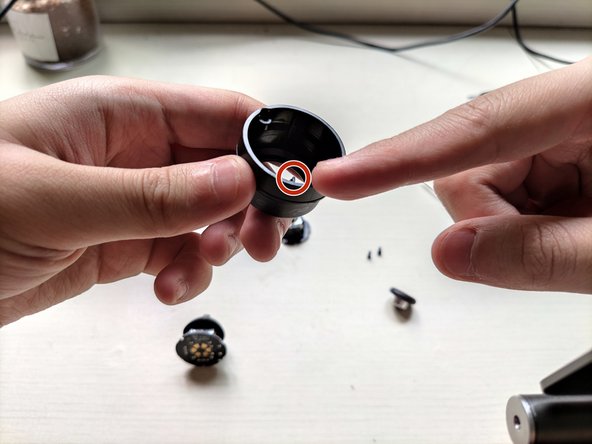

  5. Astro C40 TR Joystick Replacement: crwdns2935265:05crwdnd2935265:01crwdnd2935265:03crwdne2935265:0 Astro C40 TR Joystick Replacement: crwdns2935265:05crwdnd2935265:02crwdnd2935265:03crwdne2935265:0 Astro C40 TR Joystick Replacement: crwdns2935265:05crwdnd2935265:03crwdnd2935265:03crwdne2935265:0
    • Reassemble the joystick module and plug it back into the controller.
    • Make sure the replacement and base frame are tightly screwed together.
    • Align the module and controller as you put joystick back together.
