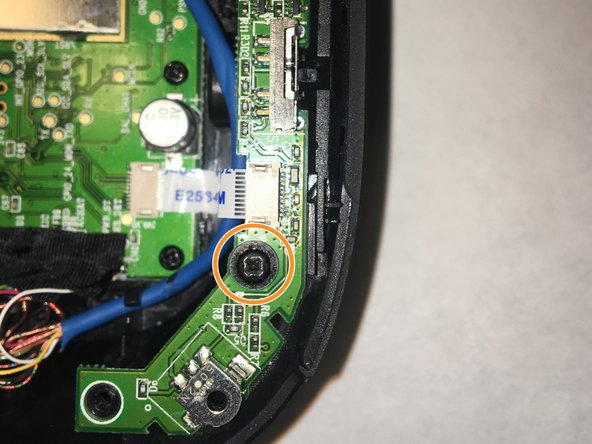

  4. Astro A50 Motherboard Replacement: crwdns2935265:04crwdnd2935265:01crwdnd2935265:02crwdne2935265:0 Astro A50 Motherboard Replacement: crwdns2935265:04crwdnd2935265:02crwdnd2935265:02crwdne2935265:0
    • Remove the motherboard remove the four 3.5mm long Phillips head screws circled in red.
    • Remove the 3.5mm Phillips head screw circled in blue to remove secondary motherboard.
  5. Astro A50 Motherboard Replacement: crwdns2935265:05crwdnd2935265:01crwdnd2935265:01crwdne2935265:0
    • Separate the secondary mother board from the motherboard by pulling firmly to the right on the white connector.
