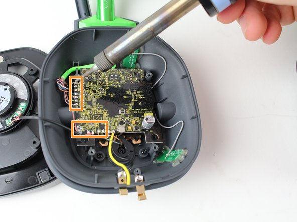

    1. Astro A50 2016 Headset Motherboard Replacement, Headset Motherboard: crwdns2935265:05crwdnd2935265:01crwdnd2935265:01crwdne2935265:0
      • Remove the four 6mm Phillips 1 screws.
    2. Astro A50 2016 Headset Motherboard Replacement: crwdns2935265:06crwdnd2935265:01crwdnd2935265:02crwdne2935265:0 Astro A50 2016 Headset Motherboard Replacement: crwdns2935265:06crwdnd2935265:02crwdnd2935265:02crwdne2935265:0
      • Use a soldering iron to desolder the black and yellow wires from the two metal plates near the bottom of the device.
      • Use a soldering iron to desolder the 13 wires in rows along the left and bottom sides of the headset motherboard.
      • How To Solder and Desolder Connections
    3. Astro A50 2016 Headset Motherboard Replacement: crwdns2935265:07crwdnd2935265:01crwdnd2935265:01crwdne2935265:0
      • Use the plastic opening tool to pry off the black tape covering the gray wires
    4. Astro A50 2016 Headset Motherboard Replacement: crwdns2935265:08crwdnd2935265:01crwdnd2935265:01crwdne2935265:0
      • Lift the motherboard out of the headset and gently disconnect the gray wires from the motherboard.
