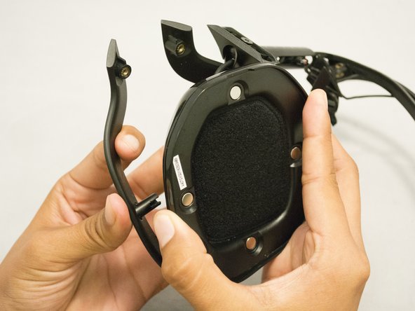

    • Use your hand to firmly grasp the cushion and remove it from the speaker.
    • Repeat the process for the other side if needed.
    • The best place to grip it is where there is a tab sticking out. The tab will make it easier to remove.
    • When reassembling, note the curvature of the cushion to determine whether it's the left or the right cushion.

  3. Astro A40 TR Plus Mixamp M80 Wires in speaker Replacement: crwdns2935265:03crwdnd2935265:01crwdnd2935265:03crwdne2935265:0 Astro A40 TR Plus Mixamp M80 Wires in speaker Replacement: crwdns2935265:03crwdnd2935265:02crwdnd2935265:03crwdne2935265:0 Astro A40 TR Plus Mixamp M80 Wires in speaker Replacement: crwdns2935265:03crwdnd2935265:03crwdnd2935265:03crwdne2935265:0
    • Remove four 5 mm screws from the speaker protector using a JIS #1 screwdriver.
    • Use your hands to remove the speaker protector.
