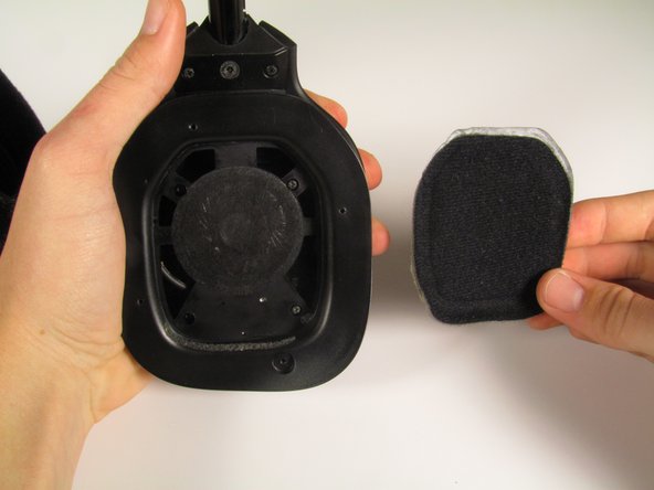

Astro A40 Gen2 Speaker Replacement
  1. Astro A40 Gen2 Speaker Replacement, Ear Pad: crwdns2935265:01crwdnd2935265:01crwdnd2935265:02crwdne2935265:0 Astro A40 Gen2 Speaker Replacement, Ear Pad: crwdns2935265:01crwdnd2935265:02crwdnd2935265:02crwdne2935265:0
    • Pull one corner of the pad to release it from the headset.
    • Pull the rest of the ear pad off.
  2. Astro A40 Gen2 Speaker Replacement, Speaker: crwdns2935265:02crwdnd2935265:01crwdnd2935265:02crwdne2935265:0 Astro A40 Gen2 Speaker Replacement, Speaker: crwdns2935265:02crwdnd2935265:02crwdnd2935265:02crwdne2935265:0
    • Locate the four 4.5 mm Philips #0 screws on the panel shown.
    • Remove them using a Phillips #0 head screwdriver.
    • Remove the panel.
  3. Astro A40 Gen2 Speaker Replacement: crwdns2935265:03crwdnd2935265:01crwdnd2935265:02crwdne2935265:0 Astro A40 Gen2 Speaker Replacement: crwdns2935265:03crwdnd2935265:02crwdnd2935265:02crwdne2935265:0
    • Using either your fingers or a plastic opening tool, pry off the speaker cover.
  4. Astro A40 Gen2 Speaker Replacement: crwdns2935265:04crwdnd2935265:01crwdnd2935265:01crwdne2935265:0
    • Locate the four 4.5 mm Philips #0 screws as shown on the speaker housing.
    • Remove the four screws using a Phillips #0 head screwdriver.
  5. Astro A40 Gen2 Speaker Replacement: crwdns2935265:05crwdnd2935265:01crwdnd2935265:01crwdne2935265:0
    • Remove the housing to reveal the speaker.
    • Make sure not to break the small wire holding the two portions together.
