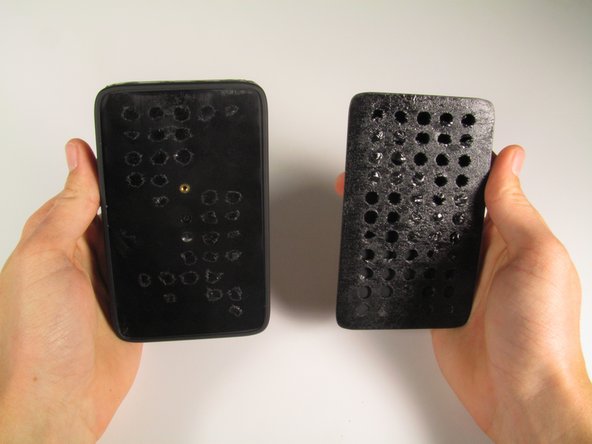

    2. Astro A40 Gen2 Mixamp Button Replacement, Remove back pad.: crwdns2935265:03crwdnd2935265:01crwdnd2935265:02crwdne2935265:0 Astro A40 Gen2 Mixamp Button Replacement, Remove back pad.: crwdns2935265:03crwdnd2935265:02crwdnd2935265:02crwdne2935265:0
      • Using a larger metal spudger, remove the rubber back of the mixamp.
      • The back will have glue residue after removal. Depending on the stickiness of the residue, more glue may be needed to stick the backing back on.
