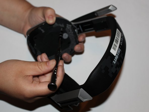

If the Astro A20 will not turn on or the battery will not charge then you will need to replace the battery.
    1. Astro A20 Battery Replacement, Cushion: crwdns2935265:01crwdnd2935265:01crwdnd2935265:01crwdne2935265:0
      • Place one hand on the hard side of the headset ear portion and on the cushion.
      • Lift the small portion on the edge of the cushion.
    2. Astro A20 Battery Replacement: crwdns2935265:02crwdnd2935265:01crwdnd2935265:01crwdne2935265:0
      • Slide the metal spudger underneath the lift part of the ear cushion.
      • Pull the ear cushion while wedging the spudge around the edge of the ear cushion.
    3. Astro A20 Battery Replacement: crwdns2935265:03crwdnd2935265:01crwdnd2935265:02crwdne2935265:0 Astro A20 Battery Replacement: crwdns2935265:03crwdnd2935265:02crwdnd2935265:02crwdne2935265:0
      • Remove the ear cushion from the headset.
    1. Astro A20 Battery Replacement, Battery: crwdns2935265:04crwdnd2935265:01crwdnd2935265:01crwdne2935265:0
      • Place hand on the opposite side of the speaker.
    2. Astro A20 Battery Replacement: crwdns2935265:05crwdnd2935265:01crwdnd2935265:02crwdne2935265:0 Astro A20 Battery Replacement: crwdns2935265:05crwdnd2935265:02crwdnd2935265:02crwdne2935265:0
      • Remove the four 7mm screws with a Phillips #1 screwdriver.
      • You may want to use a 60mm screwdriver extension to reach the screws inside of the headset.
    3. Astro A20 Battery Replacement: crwdns2935265:06crwdnd2935265:01crwdnd2935265:01crwdne2935265:0
      • Lift and remove the speaker from the headset.
    4. Astro A20 Battery Replacement: crwdns2935265:07crwdnd2935265:01crwdnd2935265:01crwdne2935265:0
      • Remove the two 7mm screws with a Phillips #1 screwdriver.
    5. Astro A20 Battery Replacement: crwdns2935265:08crwdnd2935265:01crwdnd2935265:01crwdne2935265:0
      • Lift the motherboard to expose the battery.
    6. Astro A20 Battery Replacement: crwdns2935265:09crwdnd2935265:01crwdnd2935265:01crwdne2935265:0
      • Remove the battery with a plastic spudger.

Does it work for Astro A20 2nd Gen too?
Charly - crwdns2934203:0crwdne2934203:0 crwdns2950251:0crwdne2950251:0
this guide is so wrong! 1st the battery is on the left side by the charging port (a20 2gen)
Miguel Garcia - crwdns2934203:0crwdne2934203:0 crwdns2950251:0crwdne2950251:0
That head set is A20 gen1 but main board in right side
from 7th pic that is right side
If you have no idea which is left side or right side.
just check where is buttons
