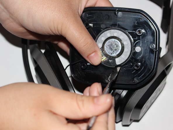

If the Astro A20 does not have any audio transmitting from the speaker then you will need to follow these steps to replace the speaker.
    1. Astro A20  Speaker Replacement, Cushion: crwdns2935265:01crwdnd2935265:01crwdnd2935265:01crwdne2935265:0
      • Place one hand on the hard side of the headset ear portion and on the cushion.
      • Lift the small portion on the edge of the cushion.
    2. Astro A20  Speaker Replacement: crwdns2935265:02crwdnd2935265:01crwdnd2935265:01crwdne2935265:0
      • Slide the metal spudger underneath the lift part of the ear cushion.
      • Pull the ear cushion while wedging the spudge around the edge of the ear cushion.
    3. Astro A20  Speaker Replacement: crwdns2935265:03crwdnd2935265:01crwdnd2935265:02crwdne2935265:0 Astro A20  Speaker Replacement: crwdns2935265:03crwdnd2935265:02crwdnd2935265:02crwdne2935265:0
      • Remove the ear cushion from the headset.
    1. Astro A20  Speaker Replacement, Speaker: crwdns2935265:04crwdnd2935265:01crwdnd2935265:01crwdne2935265:0
      • Place your hand on the opposite side of the speaker.
    2. Astro A20  Speaker Replacement: crwdns2935265:05crwdnd2935265:01crwdnd2935265:02crwdne2935265:0 Astro A20  Speaker Replacement: crwdns2935265:05crwdnd2935265:02crwdnd2935265:02crwdne2935265:0
      • Remove the four 7mm screws with a Phillips #1 screwdriver.
      • You may want to use a 60mm screwdriver extension to reach the screws inside of the headset.
    3. Astro A20  Speaker Replacement: crwdns2935265:06crwdnd2935265:01crwdnd2935265:02crwdne2935265:0 Astro A20  Speaker Replacement: crwdns2935265:06crwdnd2935265:02crwdnd2935265:02crwdne2935265:0
      • Lift the speaker area.
      • Disconnect the wires connected to the speaker.
      • Wedge a spudger on the edge of the speaker and lift upwards to remove the speaker from the device.
