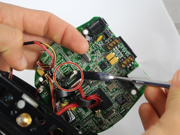

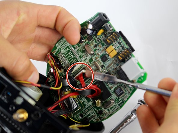

    3. Astak Mole Camera Head Replacement: crwdns2935265:08crwdnd2935265:01crwdnd2935265:03crwdne2935265:0 Astak Mole Camera Head Replacement: crwdns2935265:08crwdnd2935265:02crwdnd2935265:03crwdne2935265:0 Astak Mole Camera Head Replacement: crwdns2935265:08crwdnd2935265:03crwdnd2935265:03crwdne2935265:0
      • Separate the three indicated outputs from the motherboard with metal spudger.
      • There is electrical adhesive on the output. This can be easily separated with the metal spudger.
      • The regular black nylon spudger should be used whenever possible, especially around sensitive internal components.
    4. Astak Mole Camera Head Replacement: crwdns2935265:09crwdnd2935265:01crwdnd2935265:01crwdne2935265:0
      • Separate the wire from CPU by cutting adhesive with metal spudger.
      • It is advised to reapply adhesive to wired connections during reassembly, and to re-attach wires to CPU to prevent disconnection and loose wires inside device.
      • Be careful not to damage the CPU in the process. This is not a wired connection.
