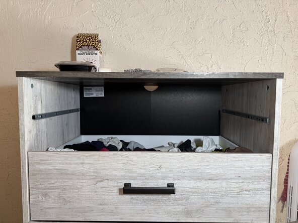

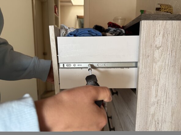

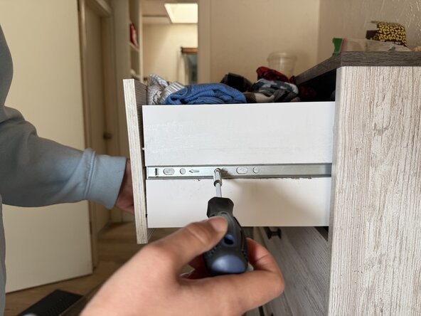

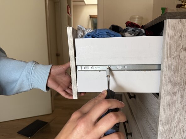

    • Pull the drawer out.
    • Emptying the drawer is optional but recommended.
    • Use a screwdriver and remove the screw connecting the drawer slide bracket to the drawer.
    • Repeat the previous bullet for both sides.

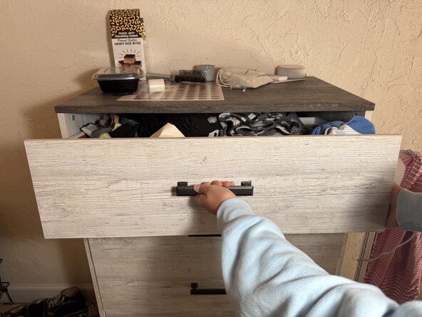

  2. Ashley Furniture's 5 Drawer Chest Drawer Slide Replacement: crwdns2935265:02crwdnd2935265:01crwdnd2935265:01crwdne2935265:0
    • Remove the drawer.

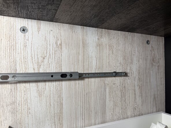

  3. Ashley Furniture's 5 Drawer Chest Drawer Slide Replacement: crwdns2935265:03crwdnd2935265:01crwdnd2935265:02crwdne2935265:0 Ashley Furniture's 5 Drawer Chest Drawer Slide Replacement: crwdns2935265:03crwdnd2935265:02crwdnd2935265:02crwdne2935265:0

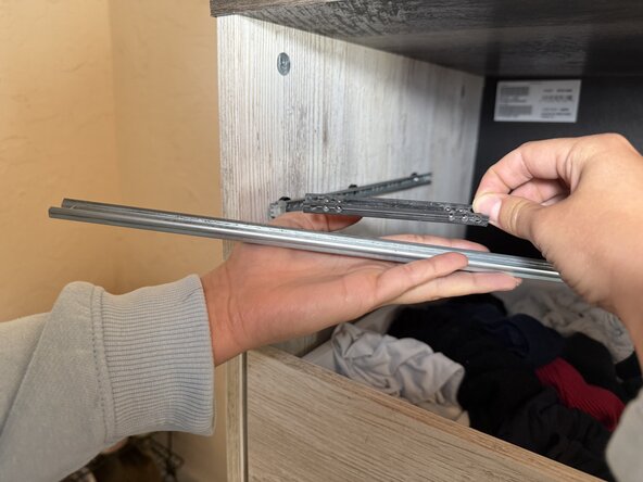

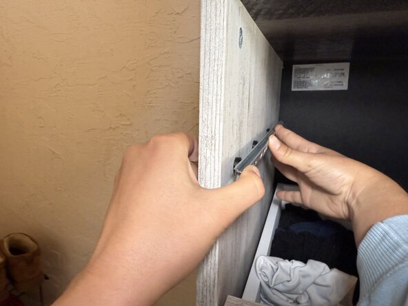

    • Pull off the drawer slide bracket from the internal railing.

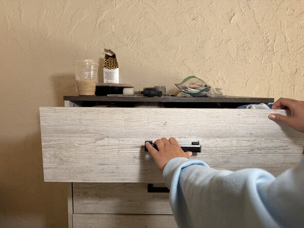

  4. Ashley Furniture's 5 Drawer Chest Drawer Slide Replacement: crwdns2935265:04crwdnd2935265:01crwdnd2935265:03crwdne2935265:0 Ashley Furniture's 5 Drawer Chest Drawer Slide Replacement: crwdns2935265:04crwdnd2935265:02crwdnd2935265:03crwdne2935265:0 Ashley Furniture's 5 Drawer Chest Drawer Slide Replacement: crwdns2935265:04crwdnd2935265:03crwdnd2935265:03crwdne2935265:0

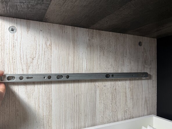

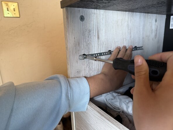

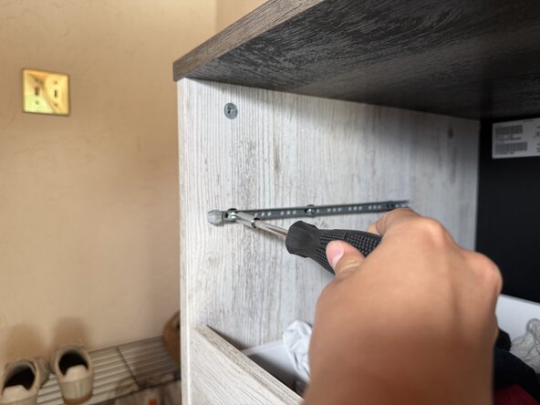

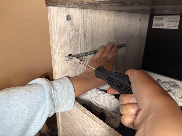

    • Remove the screws on the internal railing that needs to be replaced by twisting the screwdriver counterclockwise.

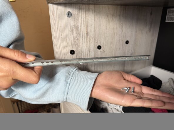

  5. Ashley Furniture's 5 Drawer Chest Drawer Slide Replacement: crwdns2935265:05crwdnd2935265:01crwdnd2935265:02crwdne2935265:0 Ashley Furniture's 5 Drawer Chest Drawer Slide Replacement: crwdns2935265:05crwdnd2935265:02crwdnd2935265:02crwdne2935265:0

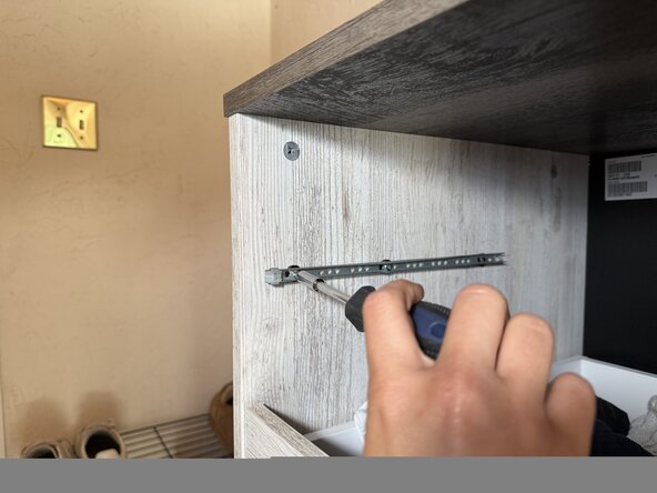

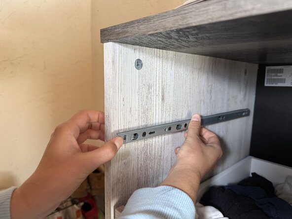

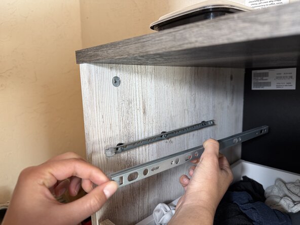

    • Hold up the new internal railing against the cabinet wall and screw it in using the same screws and by twisting the screwdriver clockwise.

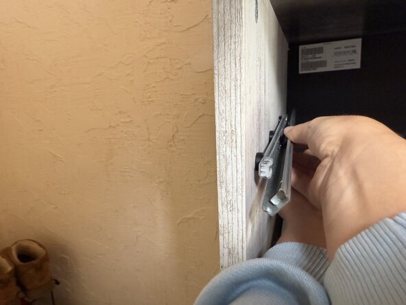

  6. Ashley Furniture's 5 Drawer Chest Drawer Slide Replacement: crwdns2935265:06crwdnd2935265:01crwdnd2935265:03crwdne2935265:0 Ashley Furniture's 5 Drawer Chest Drawer Slide Replacement: crwdns2935265:06crwdnd2935265:02crwdnd2935265:03crwdne2935265:0 Ashley Furniture's 5 Drawer Chest Drawer Slide Replacement: crwdns2935265:06crwdnd2935265:03crwdnd2935265:03crwdne2935265:0

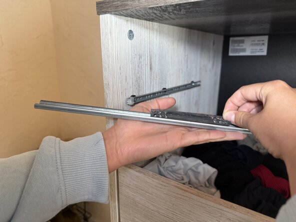

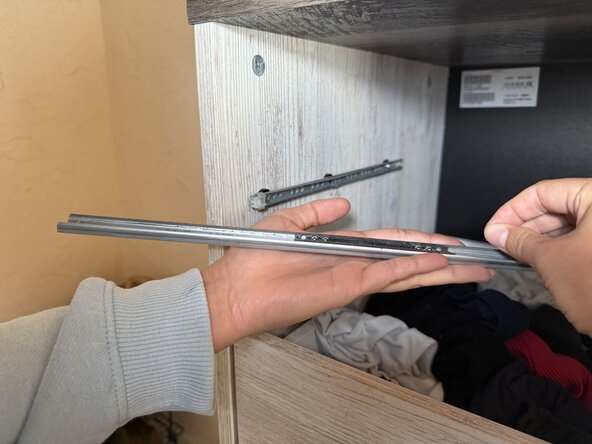

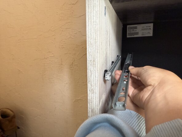

    • The drawer slide should be facing towards the ceiling and then place the ball bearing runner directly into it, so it fits snugly.
  7. Ashley Furniture's 5 Drawer Chest Drawer Slide Replacement: crwdns2935265:07crwdnd2935265:01crwdnd2935265:03crwdne2935265:0 Ashley Furniture's 5 Drawer Chest Drawer Slide Replacement: crwdns2935265:07crwdnd2935265:02crwdnd2935265:03crwdne2935265:0 Ashley Furniture's 5 Drawer Chest Drawer Slide Replacement: crwdns2935265:07crwdnd2935265:03crwdnd2935265:03crwdne2935265:0
    • Align the new drawer slide with the ball bearing runner onto the internal railing and snap them into place.

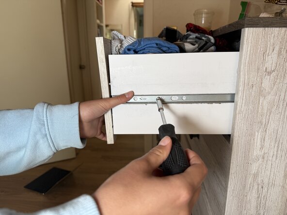

    • Screw the drawer slide back onto the drawer by turning the screwdriver clockwise.
    • Do this for both sides.
    • Then, you can push the drawer smoothly back in.
