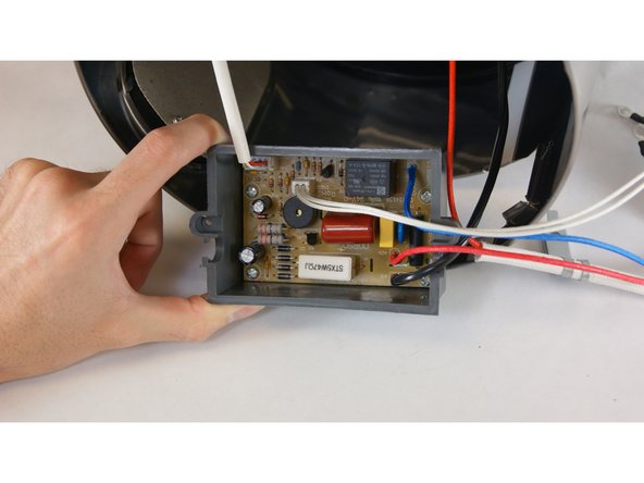

  7. Aroma ARC-914SBD Power Cord Replacement: crwdns2935265:07crwdnd2935265:01crwdnd2935265:02crwdne2935265:0 Aroma ARC-914SBD Power Cord Replacement: crwdns2935265:07crwdnd2935265:02crwdnd2935265:02crwdne2935265:0
    • Using a Phillips head screwdriver, size PH2, remove the screws from the control module to expose wired connections.

  11. Aroma ARC-914SBD Power Cord Replacement, Control Module: crwdns2935265:011crwdnd2935265:01crwdnd2935265:01crwdne2935265:0
    • Unplug the interface from the control module
  12. Aroma ARC-914SBD Power Cord Replacement: crwdns2935265:012crwdnd2935265:01crwdnd2935265:01crwdne2935265:0
    • Unplug the power from the control module

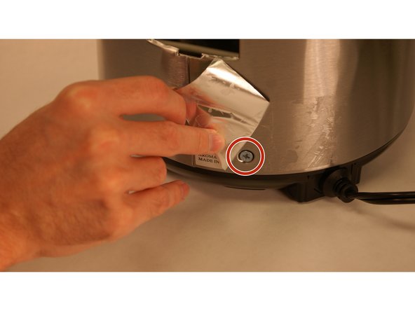

  13. Aroma ARC-914SBD Power Cord Replacement, Power Cord: crwdns2935265:013crwdnd2935265:01crwdnd2935265:03crwdne2935265:0 Aroma ARC-914SBD Power Cord Replacement, Power Cord: crwdns2935265:013crwdnd2935265:02crwdnd2935265:03crwdne2935265:0 Aroma ARC-914SBD Power Cord Replacement, Power Cord: crwdns2935265:013crwdnd2935265:03crwdnd2935265:03crwdne2935265:0
    • Locate the hidden screw behind the label and then remove it using a Phillips head screwdriver, size PH2.

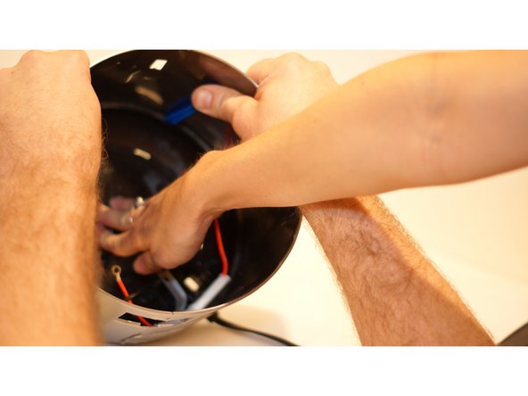

  14. Aroma ARC-914SBD Power Cord Replacement: crwdns2935265:014crwdnd2935265:01crwdnd2935265:02crwdne2935265:0 Aroma ARC-914SBD Power Cord Replacement: crwdns2935265:014crwdnd2935265:02crwdnd2935265:02crwdne2935265:0
    • Pry the black base from the stainless steel housing while pushing down on black base from inside the device. This step is much easier with two people. One person can pry while the other pushes.

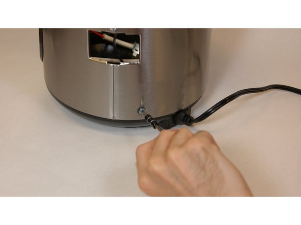

  15. Aroma ARC-914SBD Power Cord Replacement: crwdns2935265:015crwdnd2935265:01crwdnd2935265:01crwdne2935265:0
    • Using pliers, rotate the power cord clockwise to align it with the hole and simply pull it through.

I have ARC 5000SB - wanted to use this in India under 220V. Tried removing to see if I can attach voltage transformer in control circuit .. I am pretty sure no issue to heater. But couldn’t open fully … some wires are attached to lid and not possible to open upper plastic rim to access bottom circuit… any suggestions
K S Ravi Kumar - crwdns2934203:0crwdne2934203:0
Yeah, we had a lot of trouble opening it, we had to pry off the plastic from the metal to get access to those wires. It will break a few plastic tabs that hold it firmly in the metal ring. These really as we found serve no function other than preventing you from opening the cooker. It just is a hassle to get open so that you can work on these wires.
