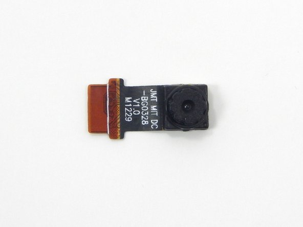

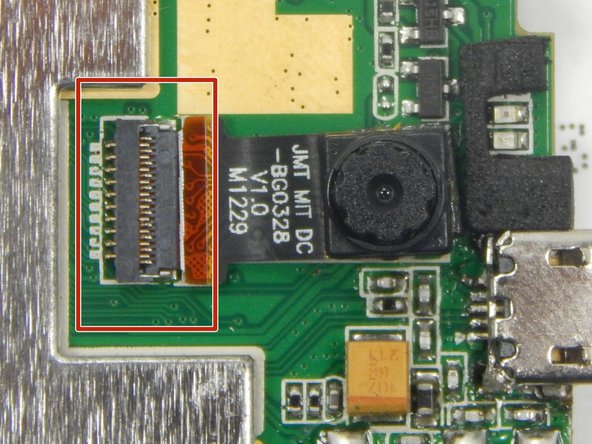

  9. Arnova 7K G3 Camera Replacement, Camera: crwdns2935265:09crwdnd2935265:01crwdnd2935265:02crwdne2935265:0 Arnova 7K G3 Camera Replacement, Camera: crwdns2935265:09crwdnd2935265:02crwdnd2935265:02crwdne2935265:0
    • Locate the camera and camera ribbon connection on the backside of the motherboard.

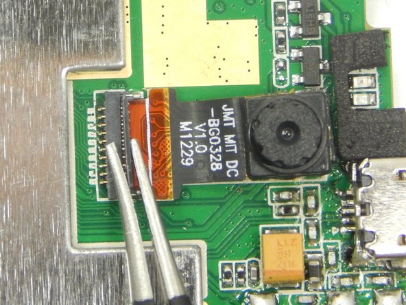

  10. Arnova 7K G3 Camera Replacement: crwdns2935265:010crwdnd2935265:01crwdnd2935265:02crwdne2935265:0 Arnova 7K G3 Camera Replacement: crwdns2935265:010crwdnd2935265:02crwdnd2935265:02crwdne2935265:0
    • Unlock the camera ribbon connector clip using a pair of tweezers.

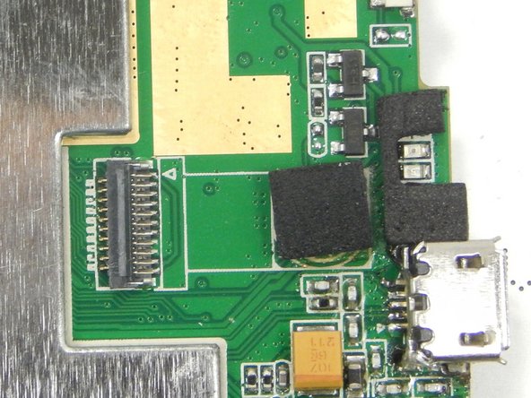

  11. Arnova 7K G3 Camera Replacement: crwdns2935265:011crwdnd2935265:01crwdnd2935265:03crwdne2935265:0 Arnova 7K G3 Camera Replacement: crwdns2935265:011crwdnd2935265:02crwdnd2935265:03crwdne2935265:0 Arnova 7K G3 Camera Replacement: crwdns2935265:011crwdnd2935265:03crwdnd2935265:03crwdne2935265:0
    • Gently by hand, remove the camera and its ribbon by pulling the camera away from the motherboard.
    • There is adhesive foam on the backside of the camera that may cause some difficulty when removing the camera.
