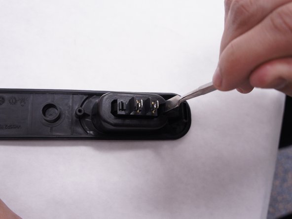

  9. ArmorAll AA255 Switch Replacement: crwdns2935265:09crwdnd2935265:01crwdnd2935265:02crwdne2935265:0 ArmorAll AA255 Switch Replacement: crwdns2935265:09crwdnd2935265:02crwdnd2935265:02crwdne2935265:0
    • Using the spudger, take out the switch. Do this by pushing the spudger against the switch on both sides as shown and then pull the switch out.
  10. ArmorAll AA255 Switch Replacement: crwdns2935265:010crwdnd2935265:01crwdnd2935265:01crwdne2935265:0
    • Replace the switch shown.
