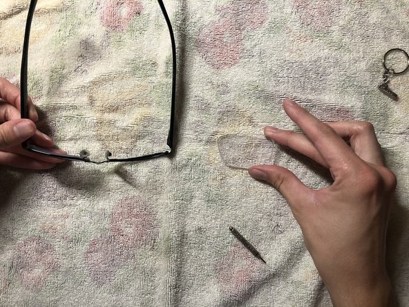

    • Clean the outer frame of the glasses with a clean cloth.
  2. Armani Exchange AX1017 Lens  Replacement: crwdns2935265:02crwdnd2935265:01crwdnd2935265:02crwdne2935265:0 Armani Exchange AX1017 Lens  Replacement: crwdns2935265:02crwdnd2935265:02crwdnd2935265:02crwdne2935265:0
    • Remove the screw between the lens and the frame using the glasses repair kit's Phillips-head screwdriver.
  3. Armani Exchange AX1017 Lens  Replacement: crwdns2935265:03crwdnd2935265:01crwdnd2935265:02crwdne2935265:0 Armani Exchange AX1017 Lens  Replacement: crwdns2935265:03crwdnd2935265:02crwdnd2935265:02crwdne2935265:0
    • Carefully remove the damaged lens from the unscrewed frame.
  4. Armani Exchange AX1017 Lens  Replacement: crwdns2935265:04crwdnd2935265:01crwdnd2935265:01crwdne2935265:0
    • Once removed, take a damp cloth (a cloth soaked in rubbing alcohol is preferred for the best clean) and clean inside of frame.
  5. Armani Exchange AX1017 Lens  Replacement: crwdns2935265:05crwdnd2935265:01crwdnd2935265:02crwdne2935265:0 Armani Exchange AX1017 Lens  Replacement: crwdns2935265:05crwdnd2935265:02crwdnd2935265:02crwdne2935265:0
    • Take your new lens and place it carefully into the frame. Make sure that the lens is slotted correctly into the frame, aligning the edges on the lens and the frame.
  6. Armani Exchange AX1017 Lens  Replacement: crwdns2935265:06crwdnd2935265:01crwdnd2935265:01crwdne2935265:0
    • Screw the frame back together using the Phillips head screwdriver, ensuring that the new lens is slotted correctly into the frame.
The guide gives complete instructions on removing, replacing, and returning the glasses back to their original state.
