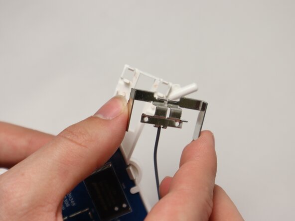

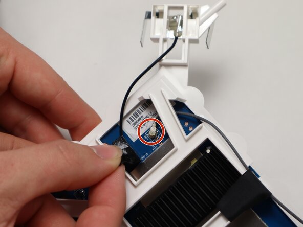

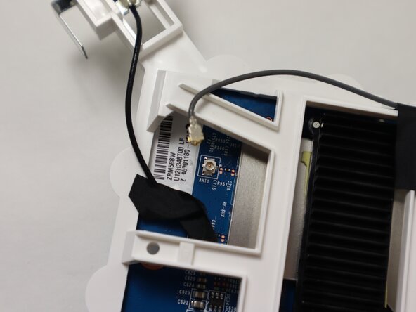

  3. Arlo Pro 2 Base Station Sensors Replacement, Base Station Sensors: crwdns2935265:03crwdnd2935265:01crwdnd2935265:03crwdne2935265:0 Arlo Pro 2 Base Station Sensors Replacement, Base Station Sensors: crwdns2935265:03crwdnd2935265:02crwdnd2935265:03crwdne2935265:0 Arlo Pro 2 Base Station Sensors Replacement, Base Station Sensors: crwdns2935265:03crwdnd2935265:03crwdnd2935265:03crwdne2935265:0
    • Follow the black wire running from each thin metal sensor to the motherboard; they will be connected under a piece of black tape.
    • Pull back the black tape to see where the wire you are following attaches to the motherboard.
    • Pull up on the coaxial connector to disconnect the wire from the motherboard.

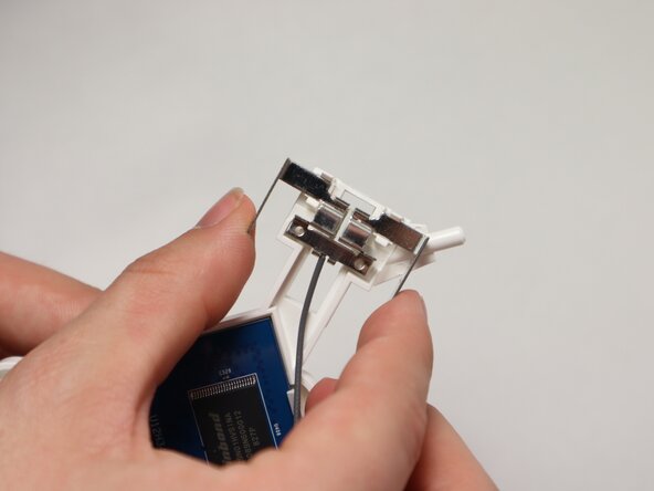

  4. Arlo Pro 2 Base Station Sensors Replacement: crwdns2935265:04crwdnd2935265:01crwdnd2935265:03crwdne2935265:0 Arlo Pro 2 Base Station Sensors Replacement: crwdns2935265:04crwdnd2935265:02crwdnd2935265:03crwdne2935265:0 Arlo Pro 2 Base Station Sensors Replacement: crwdns2935265:04crwdnd2935265:03crwdnd2935265:03crwdne2935265:0
    • Snake the wires through any place where it goes through the plastic casing.
    • Gently pull the metal sensor away from the plastic casing to fully disconnect it from the motherboard.
