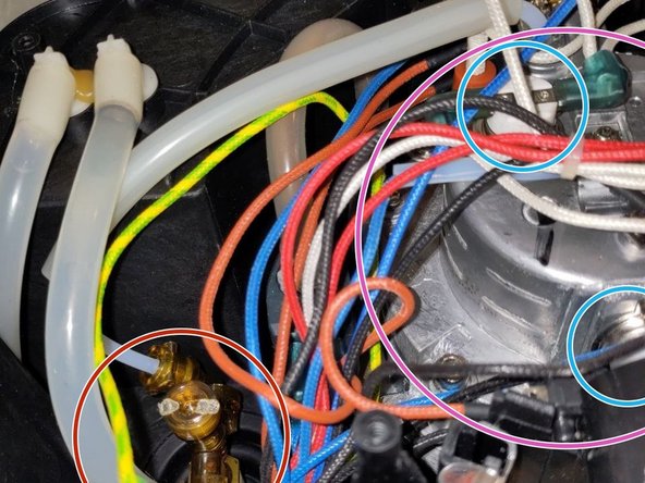

  4. Ariete Espresso Novecento 1387 Disassembly, What's in the top compartment?: crwdns2935265:04crwdnd2935265:01crwdnd2935265:02crwdne2935265:0 Ariete Espresso Novecento 1387 Disassembly, What's in the top compartment?: crwdns2935265:04crwdnd2935265:02crwdnd2935265:02crwdne2935265:0
    • Blue square: valve (I guess to release pressure at the end)
    • Green square: cables going to the pump, valve and bottom compartment.
    • Red circle: outlet of the pump. I think the translucent hose on the right side is a overpressure release (as it goes back into the water tank). The thinner one on the left goes into the heating block.
    • Pink circle: heating block. I measured 50Ω across it (230V/50Ω = 4.6A -> ~1060W). Probably different for a 110V version!
    • Blue circles: heating switches (regulate the two different temperatures for coffee and steam)
    • Caution: you're likely to do some minor damage to your coffee machine. Consider twice if you really need to get into this compartment. It only contains the cables, valve, and the pump.
