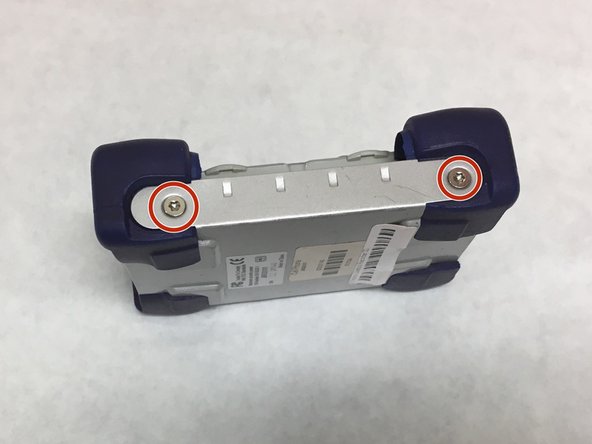

    • Use the T10 Torx Screwdriver to remove the 2 torx screws on each side of the device.
    • Two on each side for a total of four.

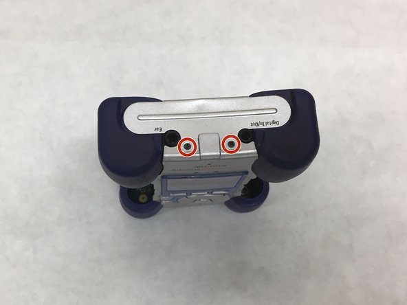

    • Remove the 2 screws on the top and the 2 screws on the bottom of the device using a Phillips #0 screwdriver.

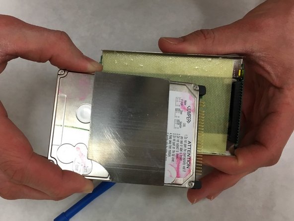

    • Lift the hard drive out of its casing with the help of a plastic opening tool and slide it out. This will disconnect the pins connecting the drive to the rest of the device.
