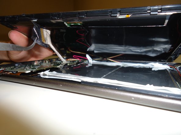

  2. Archos 97 Carbon Speakers Replacement: crwdns2935265:02crwdnd2935265:01crwdnd2935265:03crwdne2935265:0 Archos 97 Carbon Speakers Replacement: crwdns2935265:02crwdnd2935265:02crwdnd2935265:03crwdne2935265:0 Archos 97 Carbon Speakers Replacement: crwdns2935265:02crwdnd2935265:03crwdnd2935265:03crwdne2935265:0
    • Remove the tape and plug connecting the cable to the tab, and it will come loose.
    • This will loosen the cable connecting the screen to the interior of the tablet.
  3. Archos 97 Carbon Speakers Replacement: crwdns2935265:03crwdnd2935265:01crwdnd2935265:02crwdne2935265:0 Archos 97 Carbon Speakers Replacement: crwdns2935265:03crwdnd2935265:02crwdnd2935265:02crwdne2935265:0
    • Remove the black tape from the silver cable connecting the screen to the motherboard on the left side of the tablet.
    • This will loosen the gold plug.

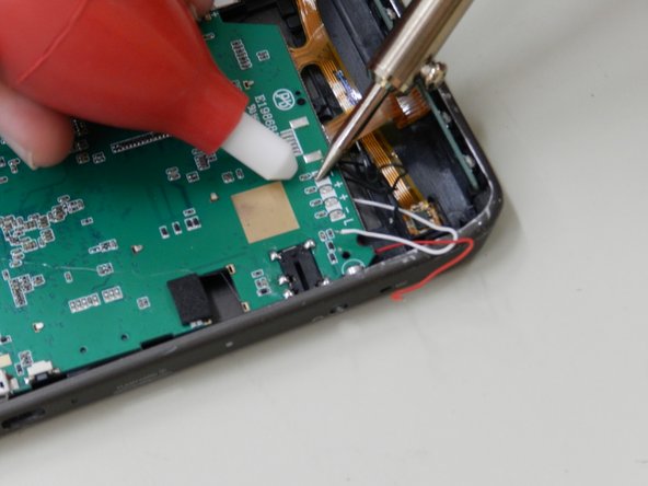

  5. Archos 97 Carbon Speakers Replacement: crwdns2935265:05crwdnd2935265:01crwdnd2935265:03crwdne2935265:0 Archos 97 Carbon Speakers Replacement: crwdns2935265:05crwdnd2935265:02crwdnd2935265:03crwdne2935265:0 Archos 97 Carbon Speakers Replacement: crwdns2935265:05crwdnd2935265:03crwdnd2935265:03crwdne2935265:0
    Desoldering Pump
    $3.99
    • Desolder each of the three wires to detach the speaker wires from the tablet.
    • There are three wires that you will desolder from the motherboard. One is red, one is black, and one is white.
    • We recommend that you use a solder sucker to suck up any of the residue that the solder produces.
  6. Archos 97 Carbon Speakers Replacement: crwdns2935265:06crwdnd2935265:01crwdnd2935265:02crwdne2935265:0 Archos 97 Carbon Speakers Replacement: crwdns2935265:06crwdnd2935265:02crwdnd2935265:02crwdne2935265:0
    • Pry each of the speakers up with an opening tool.
    • Remove the speakers and their connected wires from the tablet.
