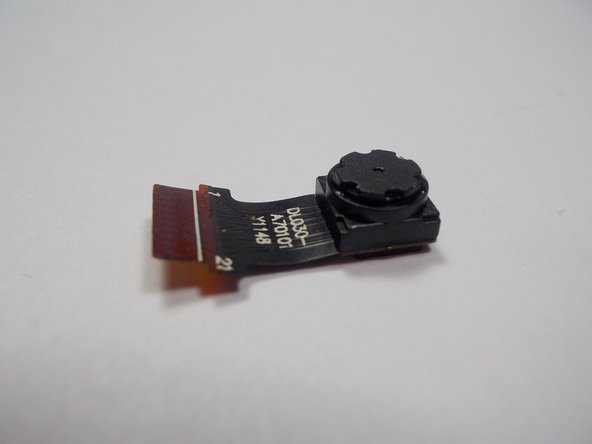

This guide will teach you how to remove and replace the camera on the Archos 70b device. It will guide you through opening the device, removing the camera from the motherboard, and then do the steps backwards to replace it.

  4. Archos 70b 0.3 MP Camera Replacement, 0.3 MP Camera: crwdns2935265:04crwdnd2935265:01crwdnd2935265:01crwdne2935265:0
    • Locate the camera on the motherboard.
  5. Archos 70b 0.3 MP Camera Replacement: crwdns2935265:05crwdnd2935265:01crwdnd2935265:01crwdne2935265:0
    • Remove the plastic cover from the camera.
    • Removal of the plastic cover makes disassembly easier.
  6. Archos 70b 0.3 MP Camera Replacement: crwdns2935265:06crwdnd2935265:01crwdnd2935265:02crwdne2935265:0 Archos 70b 0.3 MP Camera Replacement: crwdns2935265:06crwdnd2935265:02crwdnd2935265:02crwdne2935265:0
    • Using tweezers remove the camera by the pins from the motherboard.
