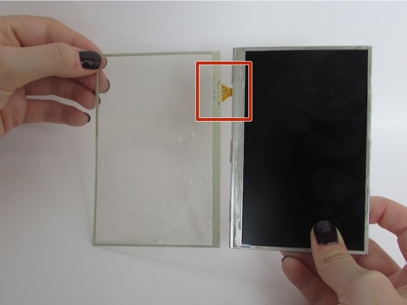

    7. Archos 5 Screen Replacement: crwdns2935265:07crwdnd2935265:01crwdnd2935265:01crwdne2935265:0
      • Peel the plastic screen away from your shattered glass screen, and replace with your new glass screen.
      • The film connecting the glass screen and the LCD screen is attached the plastic and will peel away with it. Be careful not to rip or tear it.
