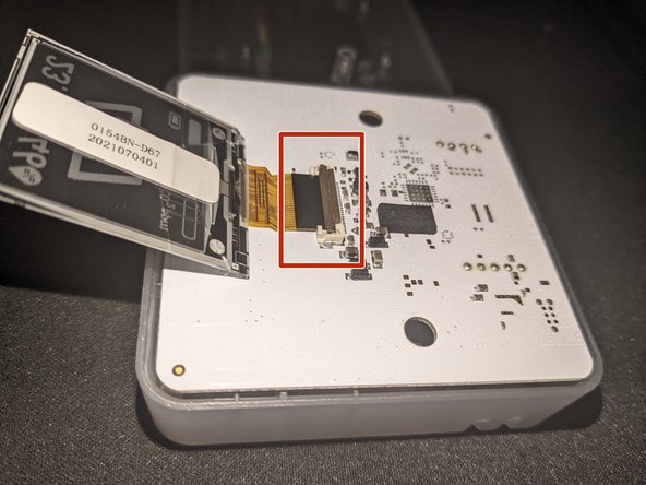

    • Pull back the screen.
    • Carefully release the display ribbon cable by, depending on your board revision either lifting the brown cover on the flip-up connector or sliding out the stuffer actuator connector. (Refer to the images for clarification.)
    • Remove the old screen.

    • Insert the new screen's cable into the connector (black side up).
    • Carefully place the front cover back and reassemble the device.
It is not necessary to remove the the board from the bottom-case, if you do wish to do this be carefull not to break the battery terminals!

Thanks for the guide! I successfully repaired my Aranet4 by following it. A couple of notes:
- I was able to get a better price than Amazon for the replacement display at https://www.waveshare.com/product/displa....
- The connector for the flexible printed circuit board on my model didn't flip up, but instead slides forward. I found documentation for the connector (or something very very similar to it) here: https://www.te.com/content/dam/te-com/do... (search for "Stuffer Actuator (Plunger Style)")
