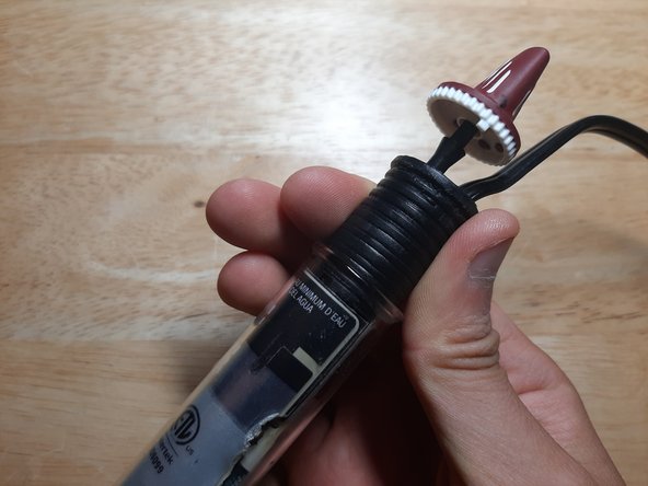

    • Unplug the device from the outlet and let the heater cool down for 5-10 minutes.
    • Remove the heater from the aquarium.
    • The glass of this aquarium heater will not crack for this model. Some other heater models may crack.
    • Using a toothbrush and running water, thoroughly scrub the aquarium heater to remove any dirt and grime.
    • Dry the heater with a paper towel.

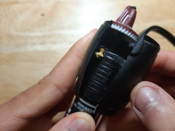

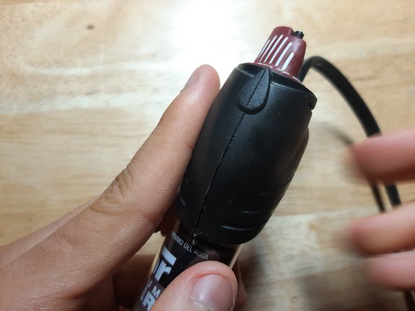

  3. Aquarium Water Heater Heating Pad Replacement: crwdns2935265:03crwdnd2935265:01crwdnd2935265:03crwdne2935265:0 Aquarium Water Heater Heating Pad Replacement: crwdns2935265:03crwdnd2935265:02crwdnd2935265:03crwdne2935265:0 Aquarium Water Heater Heating Pad Replacement: crwdns2935265:03crwdnd2935265:03crwdnd2935265:03crwdne2935265:0
    • Be sure you are wearing gloves.
    • A nylon spudger or opening tool is recommended for this step, even though a screwdriver is shown in the photo.

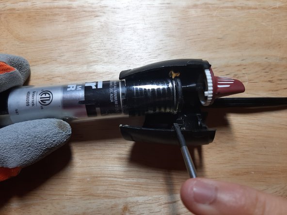

    • Starting near the bottom , slide the opening tool in between the plastic halves of the heater's dial.
    • Once the tool is in between the two plastic halves, slowly slide the tool up until either the halves separate or you hit a plastic depression clamp.
    • If you have hit the depression clamp, slightly bend the half to see if you can detach the clamp. If you cannot, slightly pull out the opening tool just enough to slide it above the depression clamp while prying the plastic halves apart.
    • Push downward and at a slight angle to detach the depression clamp and the plastic cover.

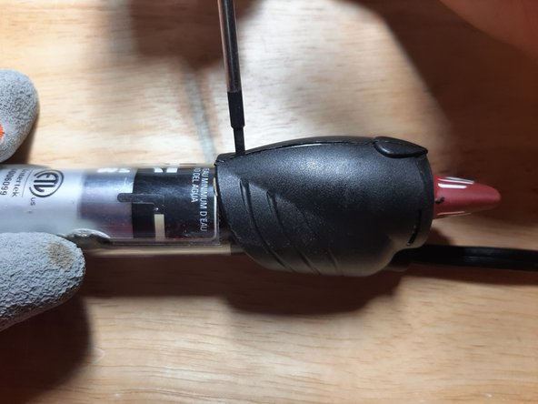

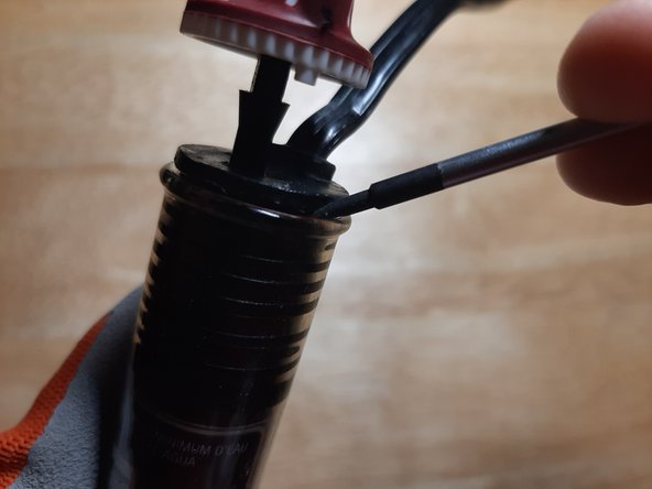

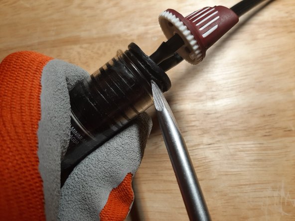

  4. Aquarium Water Heater Heating Pad Replacement: crwdns2935265:04crwdnd2935265:01crwdnd2935265:03crwdne2935265:0 Aquarium Water Heater Heating Pad Replacement: crwdns2935265:04crwdnd2935265:02crwdnd2935265:03crwdne2935265:0 Aquarium Water Heater Heating Pad Replacement: crwdns2935265:04crwdnd2935265:03crwdnd2935265:03crwdne2935265:0
    • This is one of the slowest steps in the process. Take caution since the glass can crack or shatter if done too aggressively.
    • Step requires gloves.
    • With two spudgers or opening tools, one small and the other large, carefully and slowly place the smaller one between the rubber stopper and the glass tube. Next, slowly apply pressure with a prying action to free the rubber stopper. Repeat around the stopper to eventually detach it.
    • Once a small portion is lifted continue the prying step, with the larger opener.
    • Stop when about 60%-75% of the rubber stopper is sticking out.

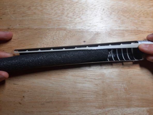

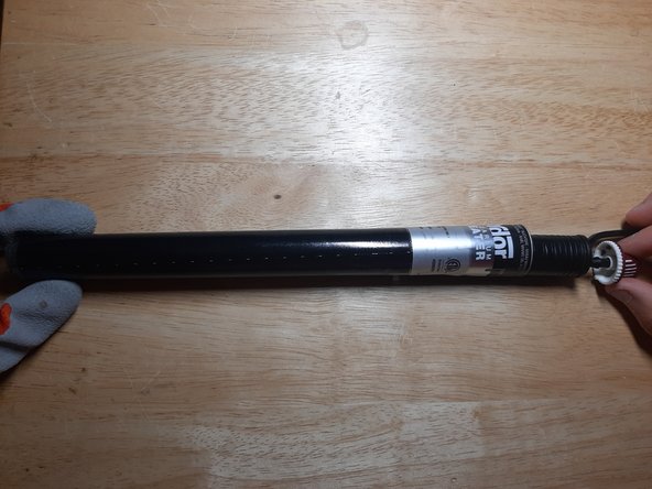

  5. Aquarium Water Heater Heating Pad Replacement: crwdns2935265:05crwdnd2935265:01crwdnd2935265:02crwdne2935265:0 Aquarium Water Heater Heating Pad Replacement: crwdns2935265:05crwdnd2935265:02crwdnd2935265:02crwdne2935265:0
    • Without twisting or turning, slowly apply a pulling force to separate the glass tube from the core components of the water heater.
    • Pulling too fast and too hard can damage the components of the heating element.

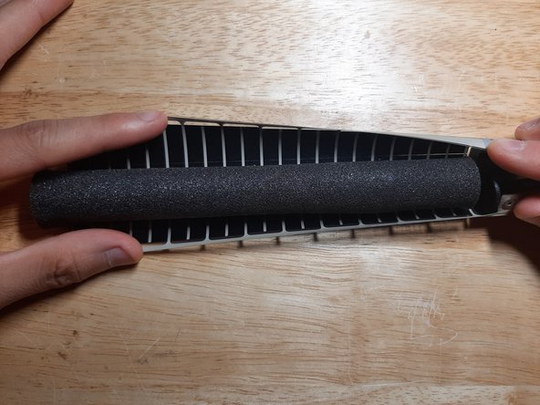

    • Locate the foam insert and carefully separate it from the heating pad.
    • Remove the foam insert.

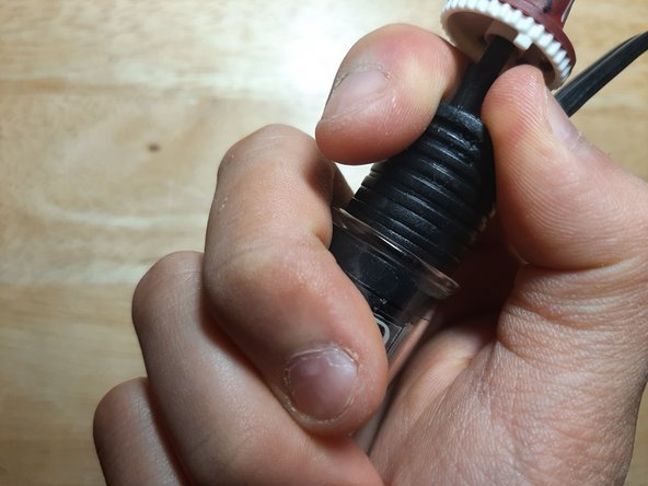

  11. Aquarium Water Heater Heating Pad Replacement: crwdns2935265:011crwdnd2935265:01crwdnd2935265:03crwdne2935265:0 Aquarium Water Heater Heating Pad Replacement: crwdns2935265:011crwdnd2935265:02crwdnd2935265:03crwdne2935265:0 Aquarium Water Heater Heating Pad Replacement: crwdns2935265:011crwdnd2935265:03crwdnd2935265:03crwdne2935265:0
    • Re-insert the foam insert back into the heating pad.
    • Compress the heating core enough to fit back into the glass tube. Stop inserting once you hit the rubber stopper.
    • The fit should be tight.
    • Once you get to the chip, make sure there is enough clearance to avoid damaging it.
