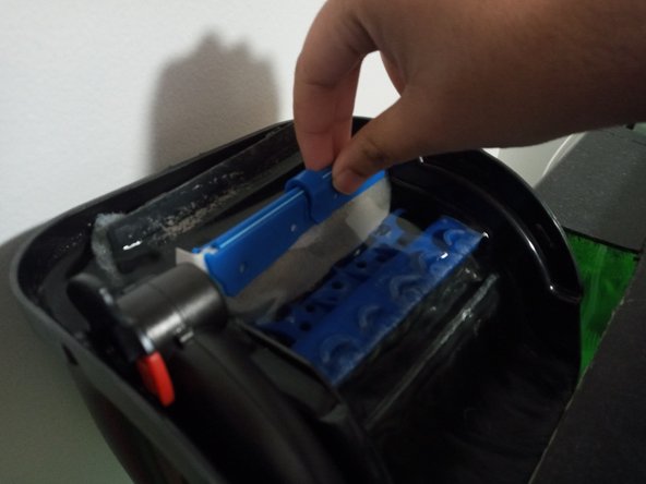

  4. Aquarium Biological Media Replacement, Remove Existing Aquarium Filter Medium: crwdns2935265:04crwdnd2935265:01crwdnd2935265:03crwdne2935265:0 Aquarium Biological Media Replacement, Remove Existing Aquarium Filter Medium: crwdns2935265:04crwdnd2935265:02crwdnd2935265:03crwdne2935265:0 Aquarium Biological Media Replacement, Remove Existing Aquarium Filter Medium: crwdns2935265:04crwdnd2935265:03crwdnd2935265:03crwdne2935265:0

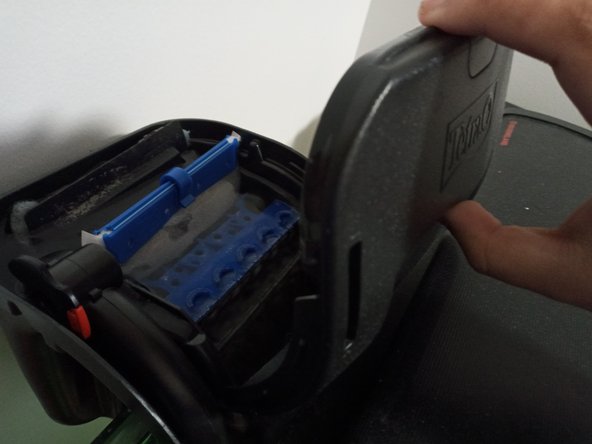

    • Unplug your aquarium filter.
    • Lift the lid of your aquarium filter's canister.
    • Carefully remove 10-25% of your biological filter media.

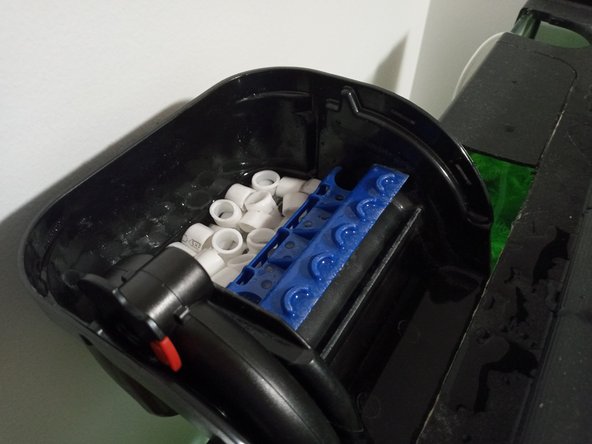

  5. Aquarium Biological Media Replacement, Insert the New Media into the Filter Canister: crwdns2935265:05crwdnd2935265:01crwdnd2935265:02crwdne2935265:0 Aquarium Biological Media Replacement, Insert the New Media into the Filter Canister: crwdns2935265:05crwdnd2935265:02crwdnd2935265:02crwdne2935265:0
    • Slowly replace the existing biological with your new pipe media: 10-25% a week, during water changes, is ideal to avoid ammonia spikes.
    • Do not replace all the media at once.
    • You have successfully replaced your biological media with a more robust and effective alternative.
