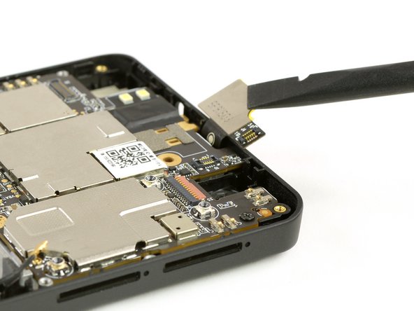

  7. Aquaris M5 Vibration Unit Replacement, Front Camera: crwdns2935265:07crwdnd2935265:01crwdnd2935265:03crwdne2935265:0 Aquaris M5 Vibration Unit Replacement, Front Camera: crwdns2935265:07crwdnd2935265:02crwdnd2935265:03crwdne2935265:0 Aquaris M5 Vibration Unit Replacement, Front Camera: crwdns2935265:07crwdnd2935265:03crwdnd2935265:03crwdne2935265:0
    • FPC Connectors can break easily, be very careful.
    • Use an opening tool or your finger nail to open the FPC connector.
    • Disconnect the FPC connector cable.
    • Use the tip of a spudger to leverage the camera out of its housing.
    • Remove the front camera.

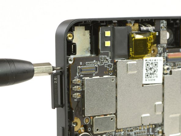

  9. Aquaris M5 Vibration Unit Replacement, Mainboard: crwdns2935265:09crwdnd2935265:01crwdnd2935265:03crwdne2935265:0 Aquaris M5 Vibration Unit Replacement, Mainboard: crwdns2935265:09crwdnd2935265:02crwdnd2935265:03crwdne2935265:0 Aquaris M5 Vibration Unit Replacement, Mainboard: crwdns2935265:09crwdnd2935265:03crwdnd2935265:03crwdne2935265:0
    • Use a SIM card eject tool, to eject the two SIM card slots on one side.
    • Use a SIM card eject tool, to eject the micro SD card slot on the other side.

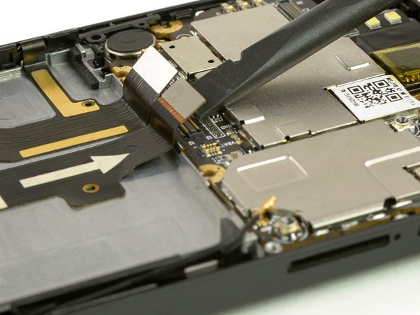

  10. Aquaris M5 Vibration Unit Replacement: crwdns2935265:010crwdnd2935265:01crwdnd2935265:03crwdne2935265:0 Aquaris M5 Vibration Unit Replacement: crwdns2935265:010crwdnd2935265:02crwdnd2935265:03crwdne2935265:0 Aquaris M5 Vibration Unit Replacement: crwdns2935265:010crwdnd2935265:03crwdnd2935265:03crwdne2935265:0
    • Use tweezers to unplug the antenna cable in the bottom right of the mainboard.
    • Use a spudger to disconnect the two flex cables at the bottom of the mainboard.

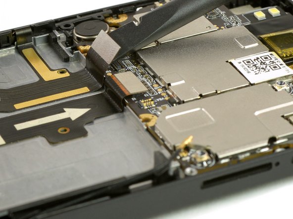

  11. Aquaris M5 Vibration Unit Replacement: crwdns2935265:011crwdnd2935265:01crwdnd2935265:02crwdne2935265:0 Aquaris M5 Vibration Unit Replacement: crwdns2935265:011crwdnd2935265:02crwdnd2935265:02crwdne2935265:0
    • Use the flat end of a spudger to disconnect the flex cable at the top of your the mainboard.
    • Bend the cable a bit over the edge, so it won't block the mainboard later, when you are taking it out.

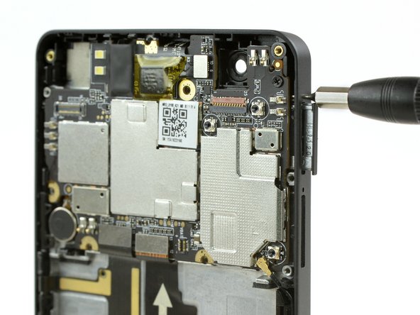

  12. Aquaris M5 Vibration Unit Replacement: crwdns2935265:012crwdnd2935265:01crwdnd2935265:01crwdne2935265:0
    • Take out the 4mm Phillips #00 screw, holding the mainboard to the frame.

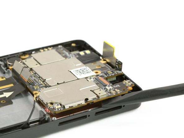

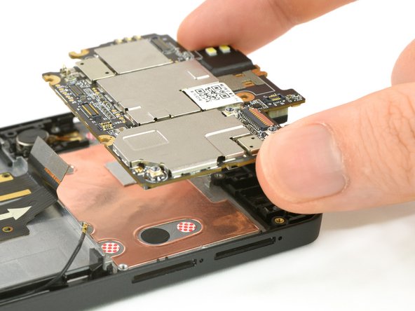

  13. Aquaris M5 Vibration Unit Replacement: crwdns2935265:013crwdnd2935265:01crwdnd2935265:03crwdne2935265:0 Aquaris M5 Vibration Unit Replacement: crwdns2935265:013crwdnd2935265:02crwdnd2935265:03crwdne2935265:0 Aquaris M5 Vibration Unit Replacement: crwdns2935265:013crwdnd2935265:03crwdnd2935265:03crwdne2935265:0
    • Insert the flat end of a spudger between the mainboard and the mid frame.
    • The best spot is on the right side next to the two SIM card slots.
    • Use the spudger to lever the mainboard.
    • Take the mainboard out of the phone.

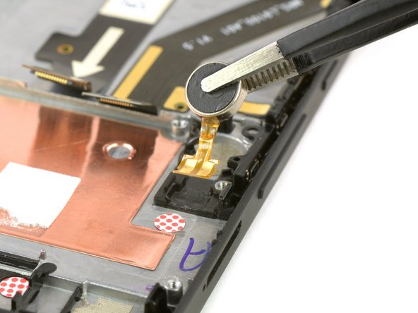

  14. Aquaris M5 Vibration Unit Replacement, Vibration Unit: crwdns2935265:014crwdnd2935265:01crwdnd2935265:02crwdne2935265:0 Aquaris M5 Vibration Unit Replacement, Vibration Unit: crwdns2935265:014crwdnd2935265:02crwdnd2935265:02crwdne2935265:0
    • Insert the tip of a spudger underneath the vibration unit to loosen it from the adhesive.
    • Use tweezers to grab the vibration unit and take it out of the phone.
