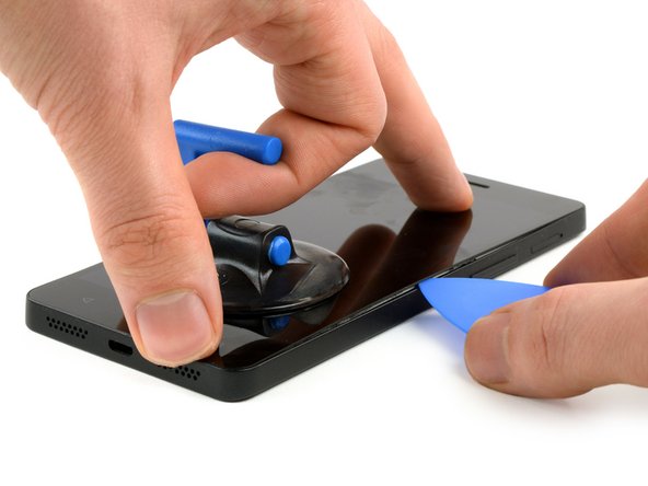

  11. Aquaris M5 Display Replacement: crwdns2935265:011crwdnd2935265:01crwdnd2935265:03crwdne2935265:0 Aquaris M5 Display Replacement: crwdns2935265:011crwdnd2935265:02crwdnd2935265:03crwdne2935265:0 Aquaris M5 Display Replacement: crwdns2935265:011crwdnd2935265:03crwdnd2935265:03crwdne2935265:0
    • Place a suction cup on the bottom-middle part of the screen and lift it up.
    • Insert the tip of an opening pick in the gap between the display and the midframe.
    • Slide the opening pick along the edge of the display to cut the adhesive.
    • Move the opening pick around the top right corner and leave it there.

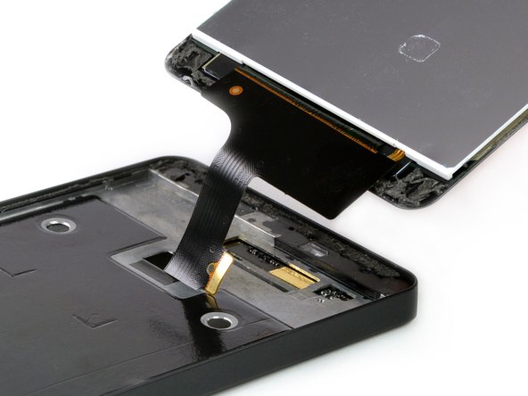

  14. Aquaris M5 Display Replacement: crwdns2935265:014crwdnd2935265:01crwdnd2935265:03crwdne2935265:0 Aquaris M5 Display Replacement: crwdns2935265:014crwdnd2935265:02crwdnd2935265:03crwdne2935265:0 Aquaris M5 Display Replacement: crwdns2935265:014crwdnd2935265:03crwdnd2935265:03crwdne2935265:0
    • Grasp the midframe of the phone with one hand and gently but steadily pull up the display to separate the adhesive of the lower part.
    • Pull the display away from the midframe, while moving the flex cable through the opening in the mid frame.
