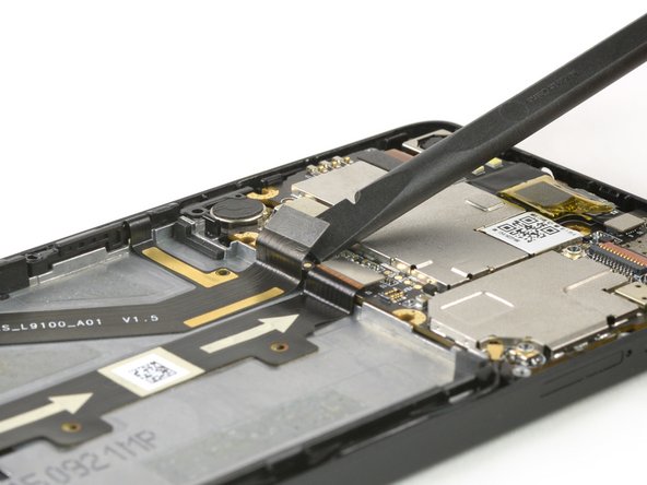

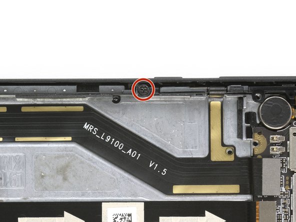

  9. Aquaris M5 Daughterboard Replacement, Daughterboard: crwdns2935265:09crwdnd2935265:01crwdnd2935265:03crwdne2935265:0 Aquaris M5 Daughterboard Replacement, Daughterboard: crwdns2935265:09crwdnd2935265:02crwdnd2935265:03crwdne2935265:0 Aquaris M5 Daughterboard Replacement, Daughterboard: crwdns2935265:09crwdnd2935265:03crwdnd2935265:03crwdne2935265:0
    • Use tweezers to disconnect the antenna cable from the daughterboard.
    • Unscrew the black Phillips #00 screw, that holds the power and volume buttons in place.
    • Use the flat end of a spudger to disconnect the flex cable from the mainboard.

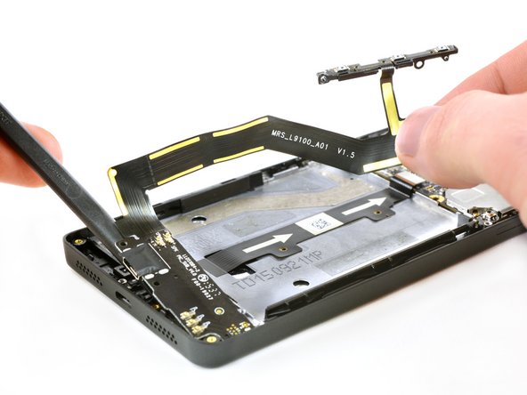

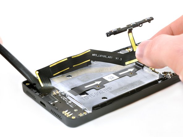

  10. Aquaris M5 Daughterboard Replacement: crwdns2935265:010crwdnd2935265:01crwdnd2935265:03crwdne2935265:0 Aquaris M5 Daughterboard Replacement: crwdns2935265:010crwdnd2935265:02crwdnd2935265:03crwdne2935265:0 Aquaris M5 Daughterboard Replacement: crwdns2935265:010crwdnd2935265:03crwdnd2935265:03crwdne2935265:0
    • Grasp the flex cable by the connector and carefully peel it off.
    • You can use a spudger to loosen the adhesive with the other hand.
    • Use a spudger to lever out the daughterboard.
    • Remove the daughterboard.
