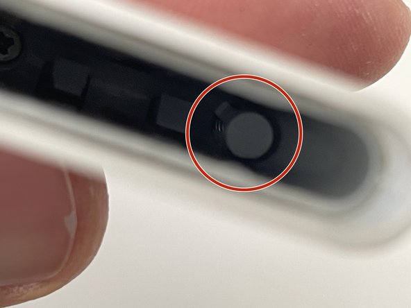

    • With the help of something small, open the battery compartment.
  2. Apple remote (A1156 EMC 2086) Teardown, Reveal the screws: crwdns2935265:02crwdnd2935265:01crwdnd2935265:03crwdne2935265:0 Apple remote (A1156 EMC 2086) Teardown, Reveal the screws: crwdns2935265:02crwdnd2935265:02crwdnd2935265:03crwdne2935265:0 Apple remote (A1156 EMC 2086) Teardown, Reveal the screws: crwdns2935265:02crwdnd2935265:03crwdnd2935265:03crwdne2935265:0

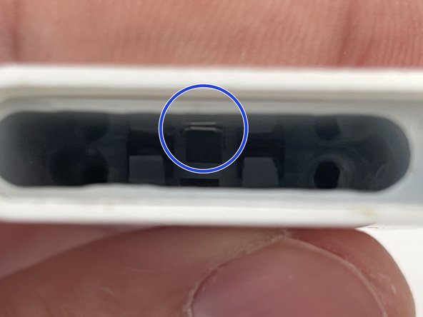

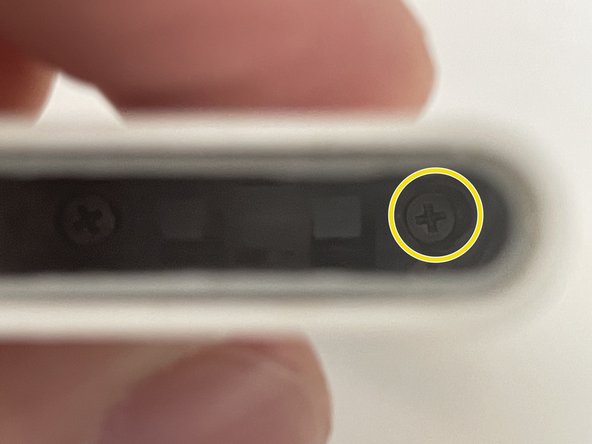

    • If you see now where the battery resides, you will see one screw.
    • But there is another one hidden under the gray piece of plastic. So we need to remove it.
    • I used the tip of a dental pick.
    • Be carful not to break the plastic, I damaged mine so in the reassemble now it is loose :-(
    • Now you can see the second screw.

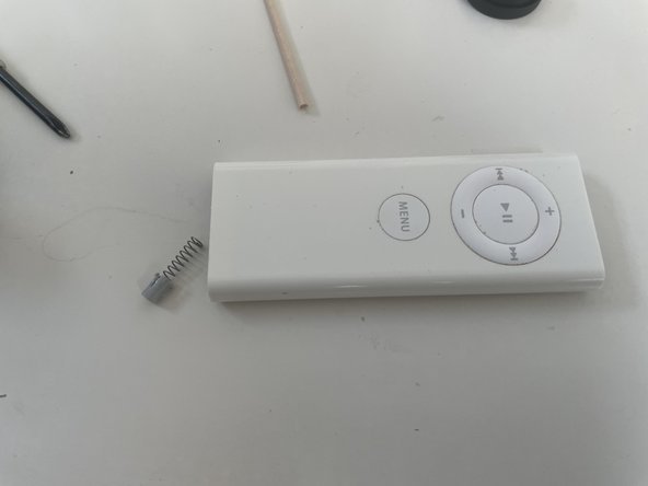

  3. Apple remote (A1156 EMC 2086) Teardown, Taking out the internals: crwdns2935265:03crwdnd2935265:01crwdnd2935265:03crwdne2935265:0 Apple remote (A1156 EMC 2086) Teardown, Taking out the internals: crwdns2935265:03crwdnd2935265:02crwdnd2935265:03crwdne2935265:0 Apple remote (A1156 EMC 2086) Teardown, Taking out the internals: crwdns2935265:03crwdnd2935265:03crwdnd2935265:03crwdne2935265:0

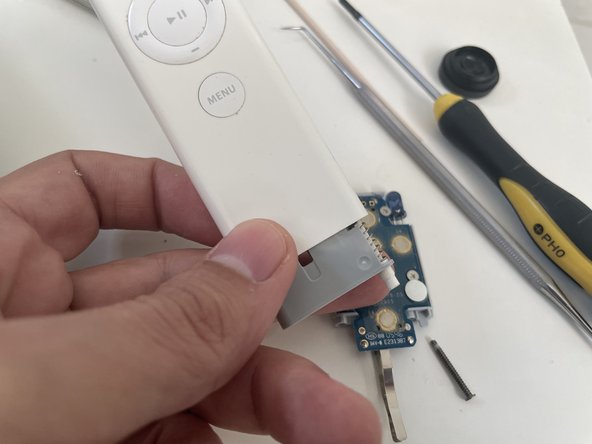

    • Undo the two screws and you can now liberate the internals in two pieces.
    • Without taking out completely one of the screws, push against it so the upper part slides out. You can now grab it with you hands and put it aside.
    • In my teardown, I took out the upper black cover first, and I broke it. In this guide you should keep it on until this point, when it should slide easily along with the upper part of the internals.
    • Now, pull the bottom part.

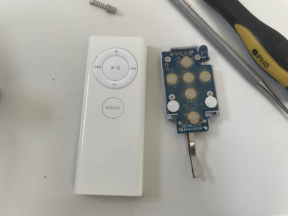

  4. Apple remote (A1156 EMC 2086) Teardown, Liberate the main board: crwdns2935265:04crwdnd2935265:01crwdnd2935265:02crwdne2935265:0 Apple remote (A1156 EMC 2086) Teardown, Liberate the main board: crwdns2935265:04crwdnd2935265:02crwdnd2935265:02crwdne2935265:0

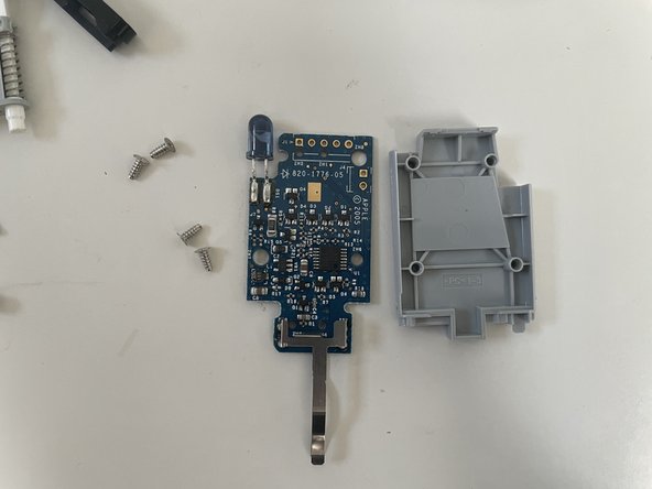

    • We have only one step to do to consider the teardown complete.
    • Undo the four screws holding the main board with a #00 phillips screwdriver.
    • Don't look at that #0 screwdriver, is a wrong one ;-)
    • Now the teardown is completed.

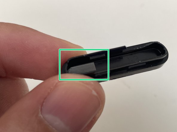

  5. Apple remote (A1156 EMC 2086) Teardown, Reassembling 1: crwdns2935265:05crwdnd2935265:01crwdnd2935265:03crwdne2935265:0 Apple remote (A1156 EMC 2086) Teardown, Reassembling 1: crwdns2935265:05crwdnd2935265:02crwdnd2935265:03crwdne2935265:0 Apple remote (A1156 EMC 2086) Teardown, Reassembling 1: crwdns2935265:05crwdnd2935265:03crwdnd2935265:03crwdne2935265:0
    • To reassembling it, we should take special care on the battery contacts are they should be springy and put under the gray bottom plastic.
    • Bend the contacts a little bit to make this shape.
    • Insert the top part, this step is easy.
    • Now insert the bottom part, but half way.
    • And, with the help of something slim, push the bottom completely making sure the battery contacts are behind the gray plastic.
    • In the picture I show you how NOT to let the contacts, it is outside the gray plastic.

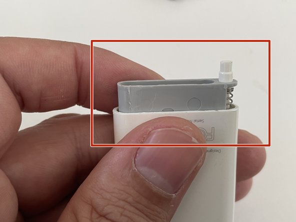

  6. Apple remote (A1156 EMC 2086) Teardown, Reassembling 2: crwdns2935265:06crwdnd2935265:01crwdnd2935265:03crwdne2935265:0 Apple remote (A1156 EMC 2086) Teardown, Reassembling 2: crwdns2935265:06crwdnd2935265:02crwdnd2935265:03crwdne2935265:0 Apple remote (A1156 EMC 2086) Teardown, Reassembling 2: crwdns2935265:06crwdnd2935265:03crwdnd2935265:03crwdne2935265:0
    • Now, screw the two screws (the shorter one is the one that is going to be covered by the spring of the release mechanism).
    • Put the spring + the plastic pusher into place.
    • Be careful on aligning the plastic piece before pushing it into place, or you may damage it.
    • And put the black top cover in place, taking special care on align it so this part is in the IR led side.
