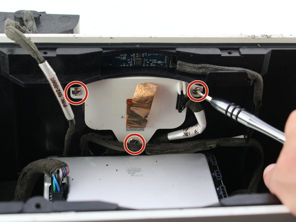

  10. Apple iPod Hi-Fi iPod Dock Inserts Replacement, iPod Dock Inserts: crwdns2935265:010crwdnd2935265:01crwdnd2935265:01crwdne2935265:0
    • Place the speaker on its back with the dock facing away from you.
  11. Apple iPod Hi-Fi iPod Dock Inserts Replacement: crwdns2935265:011crwdnd2935265:01crwdnd2935265:01crwdne2935265:0
    • Remove the cable connected to the dock insert by pulling the cable straight out.
  12. Apple iPod Hi-Fi iPod Dock Inserts Replacement: crwdns2935265:012crwdnd2935265:01crwdnd2935265:02crwdne2935265:0 Apple iPod Hi-Fi iPod Dock Inserts Replacement: crwdns2935265:012crwdnd2935265:02crwdnd2935265:02crwdne2935265:0
    • Remove the gold tape attaching the insert to the unit.
    • Remove the three 2mm Phillips #1 screws holding the dock inserts in by placing the screwdriver in the head of the screw and rotating counterclockwise.
  13. Apple iPod Hi-Fi iPod Dock Inserts Replacement: crwdns2935265:013crwdnd2935265:01crwdnd2935265:01crwdne2935265:0
    • Remove the dock insert with your hands.
