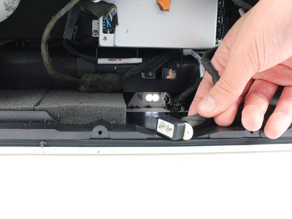

  15. Apple iPod Hi-Fi Power Supply Replacement: crwdns2935265:015crwdnd2935265:01crwdnd2935265:01crwdne2935265:0
    • Remove the middle foam panel from the wall of the device closest to you by pulling the foam out with your hand.

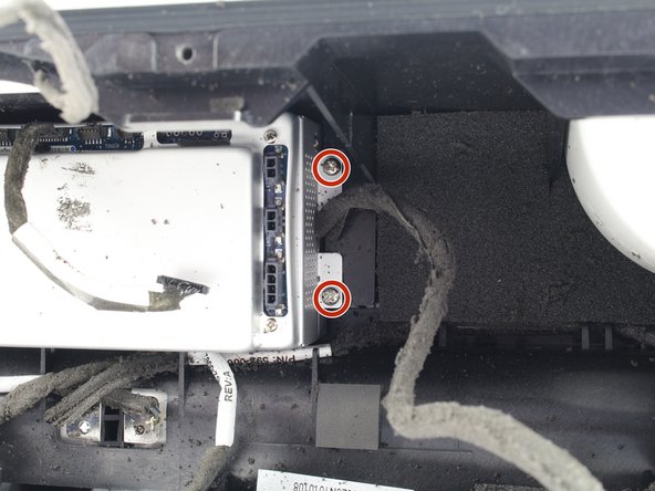

  16. Apple iPod Hi-Fi Power Supply Replacement: crwdns2935265:016crwdnd2935265:01crwdnd2935265:03crwdne2935265:0 Apple iPod Hi-Fi Power Supply Replacement: crwdns2935265:016crwdnd2935265:02crwdnd2935265:03crwdne2935265:0 Apple iPod Hi-Fi Power Supply Replacement: crwdns2935265:016crwdnd2935265:03crwdnd2935265:03crwdne2935265:0
    • Remove two 2mm Phillips #1 screws from the back power port by placing the screwdriver in the head of the screw and rotating counterclockwise.
    • Pull the power port straight out of its socket with your hands. The power port should come right out.

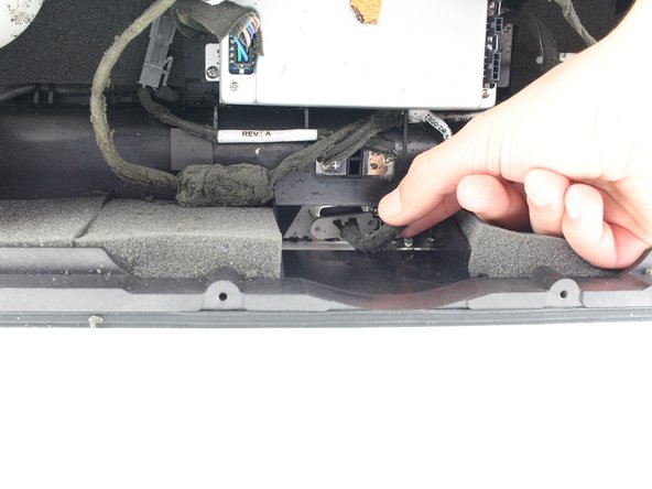

  17. Apple iPod Hi-Fi Power Supply Replacement: crwdns2935265:017crwdnd2935265:01crwdnd2935265:02crwdne2935265:0 Apple iPod Hi-Fi Power Supply Replacement: crwdns2935265:017crwdnd2935265:02crwdnd2935265:02crwdne2935265:0
    • Remove four 2mm Phillips #1 screws from the base of the power supply box by placing the screwdriver in the head of the screw and rotating counterclockwise.
  18. Apple iPod Hi-Fi Power Supply Replacement: crwdns2935265:018crwdnd2935265:01crwdnd2935265:01crwdne2935265:0
    • Remove the power supply box with your hands.
