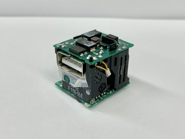

  3. Apple USB Power Adapter Teardown, Isolating internal components: crwdns2935265:03crwdnd2935265:01crwdnd2935265:03crwdne2935265:0 Apple USB Power Adapter Teardown, Isolating internal components: crwdns2935265:03crwdnd2935265:02crwdnd2935265:03crwdne2935265:0 Apple USB Power Adapter Teardown, Isolating internal components: crwdns2935265:03crwdnd2935265:03crwdnd2935265:03crwdne2935265:0
    • Isolate the internal electrical components from the casing
    • Recommend unsoldering the wires from the input panel.
    • For help desoldering connections, follow this useful guide on How To Solder and Desolder Connections.
    • Use caution when soldering. The heated tip may cause damage to the board, the components, or burn you.

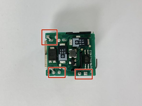

  4. Apple USB Power Adapter Teardown, Accessing individual components: crwdns2935265:04crwdnd2935265:01crwdnd2935265:03crwdne2935265:0 Apple USB Power Adapter Teardown, Accessing individual components: crwdns2935265:04crwdnd2935265:02crwdnd2935265:03crwdne2935265:0 Apple USB Power Adapter Teardown, Accessing individual components: crwdns2935265:04crwdnd2935265:03crwdnd2935265:03crwdne2935265:0
    • Unsolder components that connect to the bottom and top circuit boards.
    • Detach the top and bottom circuit boards from the plastic separator.

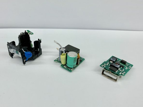

  5. Apple USB Power Adapter Teardown, Exploration: crwdns2935265:05crwdnd2935265:01crwdnd2935265:02crwdne2935265:0 Apple USB Power Adapter Teardown, Exploration: crwdns2935265:05crwdnd2935265:02crwdnd2935265:02crwdne2935265:0
    • Observe that once the circuit boards are separated individual components can be accessed.
