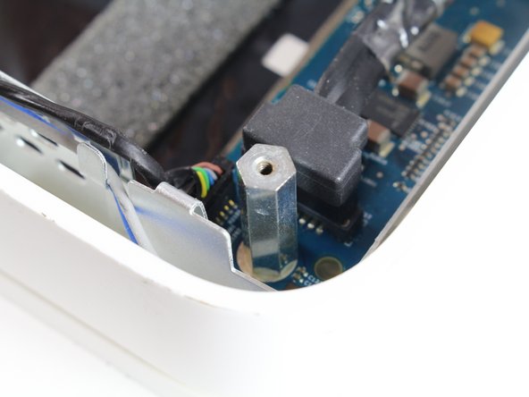

  10. Apple Time Capsule Model A1254 Logic Board Replacement: crwdns2935265:010crwdnd2935265:01crwdnd2935265:02crwdne2935265:0 Apple Time Capsule Model A1254 Logic Board Replacement: crwdns2935265:010crwdnd2935265:02crwdnd2935265:02crwdne2935265:0
    • Remove the three hexagonal mounting blocks by twisting them counter clockwise.
    • Some of the mounting blocks may need to be loosened by a wrench or a small set of plyers first before being removed by hand.
  11. Apple Time Capsule Model A1254 Logic Board Replacement: crwdns2935265:011crwdnd2935265:01crwdnd2935265:01crwdne2935265:0
    • Press in the two aluminum tabs to lift the board up and out from under the tabs.
    • There are still connectors keeping the board attached to the device shell. Do NOT remove the board all the way at this step, just out from under the tabs.

Between step 12 and 13 there is no detail on how to remove the board! I did the procedure until step #12 but board is firmly attached to the case! even after pullling the metal tabs it’s still glued to the base, please help
Juan Fonseca - crwdns2934203:0crwdne2934203:0
The board seems stuck because of sticky thermal pads between the chips and the housing. Assuming all screws are removed and cables disconnected, you should be able to pull up the board by just applying force. Hope this helps.
