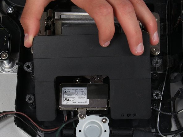

    • To the left of the middle speaker (the large black component in the middle of the device), there will be a couple of wires.
    • Use the tweezers to remove the piece of tape to free the wires.
    • Next, to the right of that piece of tape is black electrical tape that needs to be removed.
    • Use the tweezers to remove the piece of black tape.
    • Don't worry if you rip any tape as you can add a new piece when putting the speakers back.
  10. Apple Thunderbolt Display Speaker Replacement: crwdns2935265:010crwdnd2935265:01crwdnd2935265:01crwdne2935265:0

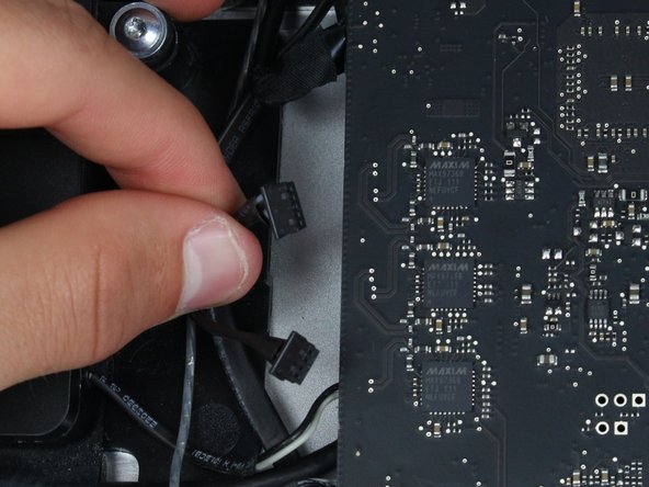

    • To the right of the middle speaker is the logic board. Here is where the three speakers in the display are connected and need to be removed.
  11. Apple Thunderbolt Display Speaker Replacement: crwdns2935265:011crwdnd2935265:01crwdnd2935265:02crwdne2935265:0 Apple Thunderbolt Display Speaker Replacement: crwdns2935265:011crwdnd2935265:02crwdnd2935265:02crwdne2935265:0
    • To remove the right speaker, disconnect the middle of the three wires.
    • Pull carefully on the connector to release the wires from the socket in the logic board.
  12. Apple Thunderbolt Display Speaker Replacement: crwdns2935265:012crwdnd2935265:01crwdnd2935265:02crwdne2935265:0 Apple Thunderbolt Display Speaker Replacement: crwdns2935265:012crwdnd2935265:02crwdnd2935265:02crwdne2935265:0
    • To remove the left speaker, locate the topmost connector of the three.
    • Carefully pull on the connector to release it from its socket in the logic board.
  13. Apple Thunderbolt Display Speaker Replacement: crwdns2935265:013crwdnd2935265:01crwdnd2935265:02crwdne2935265:0 Apple Thunderbolt Display Speaker Replacement: crwdns2935265:013crwdnd2935265:02crwdnd2935265:02crwdne2935265:0
    • The bottom of the three connectors goes to the middle speaker and has both a black and white wire.
    • Carefully pull on the connector to release the wires from the socket in the logic board.
  14. Apple Thunderbolt Display Speaker Replacement: crwdns2935265:014crwdnd2935265:01crwdnd2935265:03crwdne2935265:0 Apple Thunderbolt Display Speaker Replacement: crwdns2935265:014crwdnd2935265:02crwdnd2935265:03crwdne2935265:0 Apple Thunderbolt Display Speaker Replacement: crwdns2935265:014crwdnd2935265:03crwdnd2935265:03crwdne2935265:0

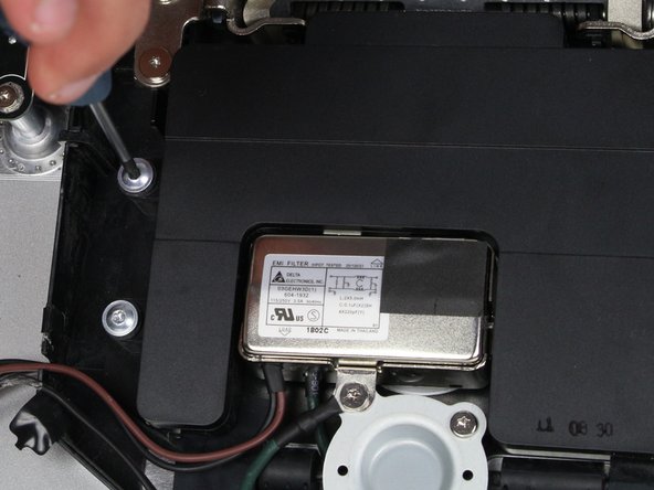

    • To remove the middle speaker, four screws must be removed.
    • Use the TR 10 screwdriver to remove the four screws and lift the speaker from its spot.
  15. Apple Thunderbolt Display Speaker Replacement: crwdns2935265:015crwdnd2935265:01crwdnd2935265:01crwdne2935265:0
    • The middle speaker is now free and can be repaired/replaced!
