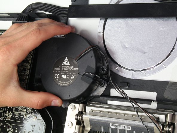

  9. Apple Thunderbolt Display Fan Replacement, Fan: crwdns2935265:09crwdnd2935265:01crwdnd2935265:01crwdne2935265:0
    • Now you should have access to the rest of the display. From here, locate the fan.
  10. Apple Thunderbolt Display Fan Replacement: crwdns2935265:010crwdnd2935265:01crwdnd2935265:03crwdne2935265:0 Apple Thunderbolt Display Fan Replacement: crwdns2935265:010crwdnd2935265:02crwdnd2935265:03crwdne2935265:0 Apple Thunderbolt Display Fan Replacement: crwdns2935265:010crwdnd2935265:03crwdnd2935265:03crwdne2935265:0
    • The fan is connected to the main logic board by two connectors. Make sure that while disconnecting them, grab the wire at the point closest to the board and the pull slowly to avoid damaging the connectors.
    • Remove the piece of tape that is holding the wires to the casing.
  11. Apple Thunderbolt Display Fan Replacement: crwdns2935265:011crwdnd2935265:01crwdnd2935265:02crwdne2935265:0 Apple Thunderbolt Display Fan Replacement: crwdns2935265:011crwdnd2935265:02crwdnd2935265:02crwdne2935265:0
    • Next, you can see that the fan is connected to the casing by three screws.
    • Use the TR 10 screwdriver to remove these three screws.
  12. Apple Thunderbolt Display Fan Replacement: crwdns2935265:012crwdnd2935265:01crwdnd2935265:01crwdne2935265:0
    • Make sure to carefully remove the fan after it is free of the casing as to not damage surrounding parts.
    • Switch out the old fan with the new one and you're all set!

I have been having trouble with fan noise -- a noisy, rapid thumping sound, especially on startup but getting worse over a few weeks and lately persisting all day. Following this excellent guide, I removed the fan and examined it. I could see nothing wrong except perhaps a fine layer of dust on the blades, no worse than could be expected. I did not manage to disassemble the fan itself, as its two-part housing is very firmly clipped together, but applied a vacuum cleaner hose to both the entry and exit sides to clean it up as much as possible. I put it back and reassembled the whole display, and am pleased to report that the noise has completely disappeared. This may be good news to anyone dismayed by the apparent non-availability of replacement fans.

I had the rumbling fan cleaned by a pro. but the rattling didn't go. I just finished replacing the fan on my 27'' Thunderbolt Display using these instructions, and so far so good after 3 hours. It usually started the rattling after 30mn!
I purchased the fan on eBay. There were a couple available then.
I got the fan for $18 and spent 30mn on the job. At the Apple certified spot in town, they were going to charge me $250! I bought this Apple Display second hand for $250! and now it is back to its old self, working like a charm :)
Thank you very much for this web page which walked me through the process.
By the way, for a succion cup I used the two small ones that are attached to my soap holder, from the bathroom tiled wall; worked just fine and I didn't have to spend $20 to buy one.
