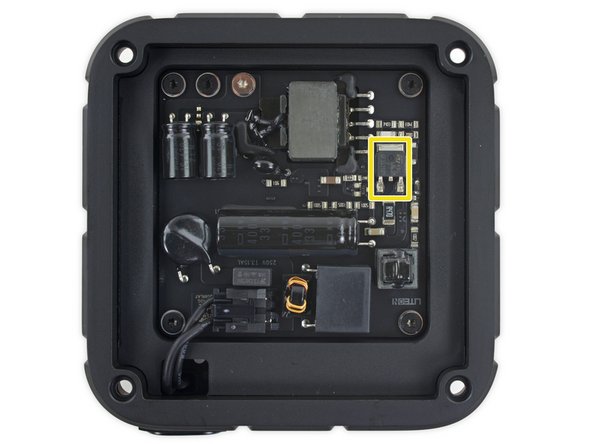

    • Last to come out of the box: a great big chunky heat sink with a cute little power supply board tucked away inside.
    • Heat rises, so this heat-generating component lives on top of the stack, with the heat-sensitive logic board beneath.
    • The redesigned power supply is rated at 12 V at 0.917 A. Compare that to the 3rd-gen Apple TV's main reactor, which pumped out 3.4 V at 1.75 A.
    • We noticed a distinct lack of cables connecting the power supply to the logic board. We're theorizing the power is either transmitted by magic, or through the heat sink screw posts.
    • And as a fun bonus, some chips:
    • NXP Semiconductor TEA1738LT switch mode power supply controller
    • Toshiba TLP291 photocoupler
    • STMicroelectronics STF6N65M2 650 V N-channel MOSFET

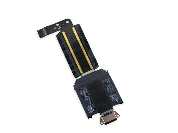

    • Look at that! A ZIF connected Lightning port cable.
    • If Apple can pack a ZIF connector into a tiny remote like this then why is the iPad Lightning port soldered to the logic board?
    • Answer: Apple proprietary secret.
    • With just a bit of glue to pick apart, the Lightning cable/battery is out in a flash.

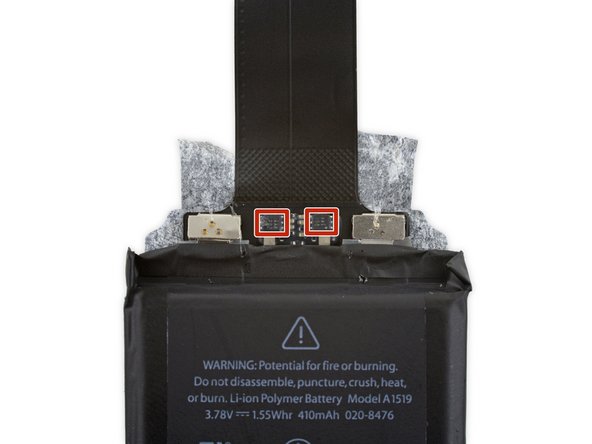

  14. Apple TV 4th Generation Teardown: crwdns2935265:014crwdnd2935265:01crwdnd2935265:03crwdne2935265:0 Apple TV 4th Generation Teardown: crwdns2935265:014crwdnd2935265:02crwdnd2935265:03crwdne2935265:0 Apple TV 4th Generation Teardown: crwdns2935265:014crwdnd2935265:03crwdnd2935265:03crwdne2935265:0
    • With the Lightning port/battery assembly free of the remote, we see that the battery is soldered to the Lightning port.
    • While we've never been a fan of soldered-on batteries, at least the Lightning port isn't soldered to the logic board!
    • Because this 410 mAh battery is rechargeable, you'll never scramble to find batteries for your TV remote again. Thanks, Apple!
    • At least not until it dies and you need to replace it.
    • And hiding out at the base of the flex cable are two ABLIC, Inc battery protection chips.
