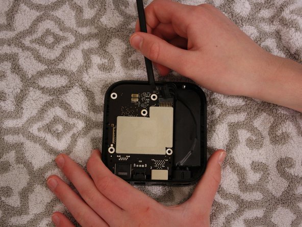

    1. Apple TV 3rd Generation Disassembly, Open the bottom: crwdns2935265:01crwdnd2935265:01crwdnd2935265:03crwdne2935265:0 Apple TV 3rd Generation Disassembly, Open the bottom: crwdns2935265:01crwdnd2935265:02crwdnd2935265:03crwdne2935265:0 Apple TV 3rd Generation Disassembly, Open the bottom: crwdns2935265:01crwdnd2935265:03crwdnd2935265:03crwdne2935265:0
      • Insert a Jimmy into the left side of the Apple TV, then work your way around the bottom and pull the base off.
    2. Apple TV 3rd Generation Disassembly: crwdns2935265:02crwdnd2935265:01crwdnd2935265:03crwdne2935265:0 Apple TV 3rd Generation Disassembly: crwdns2935265:02crwdnd2935265:02crwdnd2935265:03crwdne2935265:0 Apple TV 3rd Generation Disassembly: crwdns2935265:02crwdnd2935265:03crwdnd2935265:03crwdne2935265:0
      • First, peel off the thermal heat sink.
      • Then, using a Phillips #0 screwdriver, unscrew the 5 screws holding the heat sink.

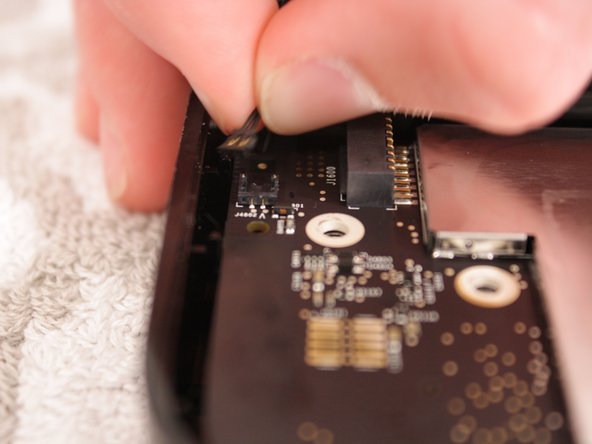

    3. Apple TV 3rd Generation Disassembly, Unfasten the cables: crwdns2935265:03crwdnd2935265:01crwdnd2935265:03crwdne2935265:0 Apple TV 3rd Generation Disassembly, Unfasten the cables: crwdns2935265:03crwdnd2935265:02crwdnd2935265:03crwdne2935265:0 Apple TV 3rd Generation Disassembly, Unfasten the cables: crwdns2935265:03crwdnd2935265:03crwdnd2935265:03crwdne2935265:0
      • 1. Unhook the Power Supply Cable.
      • 2. Unhook the IR Sensor cable
      • Lift the logic board up with a Spudger.
    4. Apple TV 3rd Generation Disassembly: crwdns2935265:04crwdnd2935265:01crwdnd2935265:01crwdne2935265:0
      • Using a Metal Spudger, lift off the bottom base and power supply.
