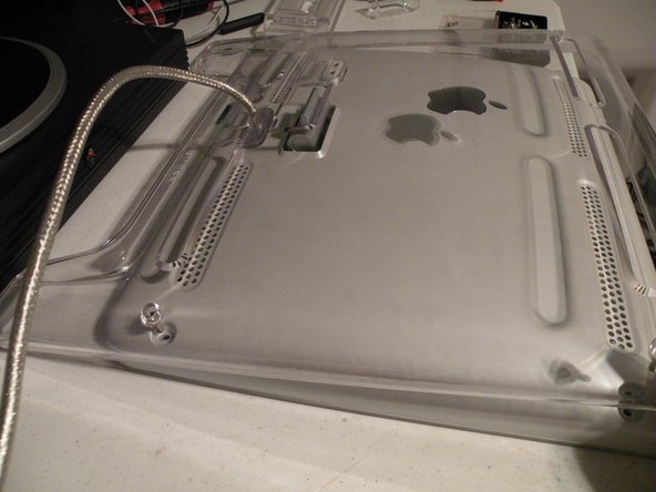

    • Start by fliping the display so it is face down.
    • Remove these 3 hex screws on the swing arm of the display.
    • Then remove the swing arm, and the piece of plastic underneath it.

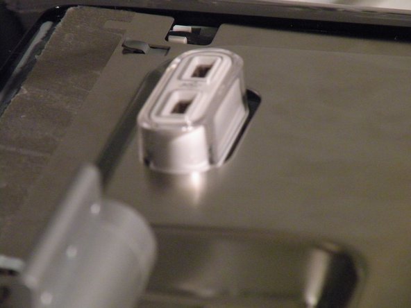

  4. Apple Studio Display M7649 Teardown: crwdns2935265:04crwdnd2935265:01crwdnd2935265:03crwdne2935265:0 Apple Studio Display M7649 Teardown: crwdns2935265:04crwdnd2935265:02crwdnd2935265:03crwdne2935265:0 Apple Studio Display M7649 Teardown: crwdns2935265:04crwdnd2935265:03crwdnd2935265:03crwdne2935265:0

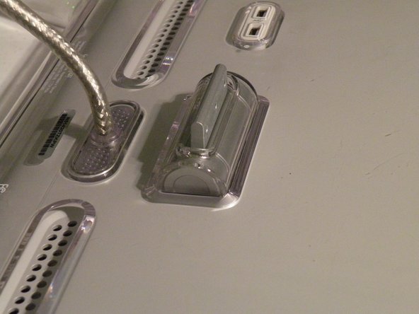

    • To remove the back panel, remove these hex screws.
    • Then lift the panel from the top of the display.

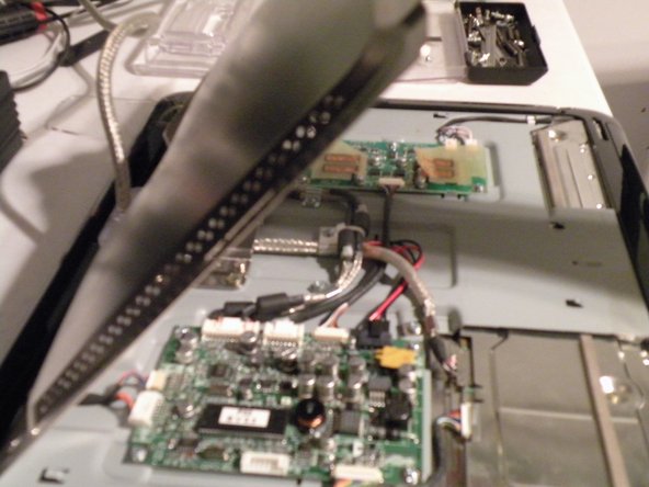

    • Removing the 2nd panel:
    • Grasp the bottom of the 2nd panel and lift it up, route the ADB cable through the hole.

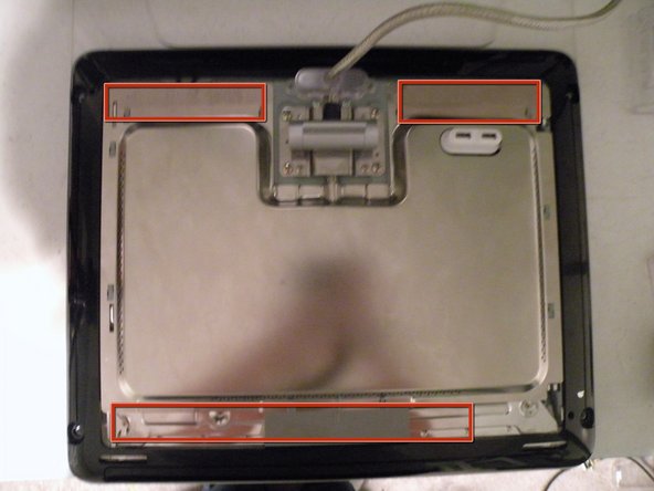

    • This will reveal a shiney metal panel.
    • There may be tape here, remove it.

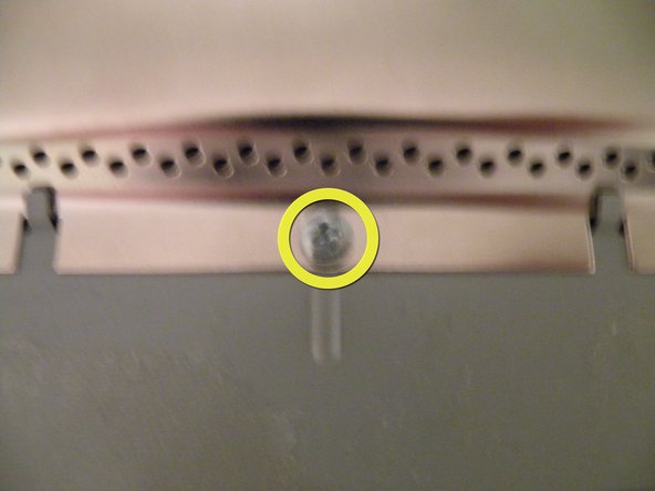

    • Remove this screw.
  6. Apple Studio Display M7649 Teardown: crwdns2935265:06crwdnd2935265:01crwdnd2935265:03crwdne2935265:0 Apple Studio Display M7649 Teardown: crwdns2935265:06crwdnd2935265:02crwdnd2935265:03crwdne2935265:0 Apple Studio Display M7649 Teardown: crwdns2935265:06crwdnd2935265:03crwdnd2935265:03crwdne2935265:0

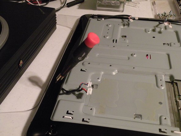

    • Removing the metal shield:
    • After the tape and screw is removed, slide the panel towards you and lift it out.

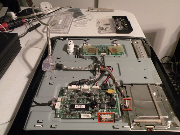

    • Also, remove the clear USB port cover.
    • We now have full access to the electronics.

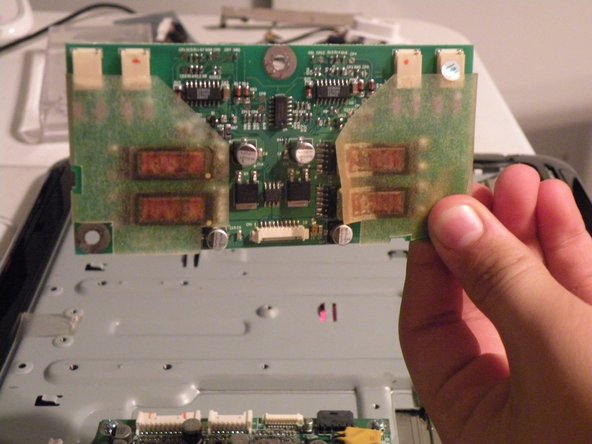

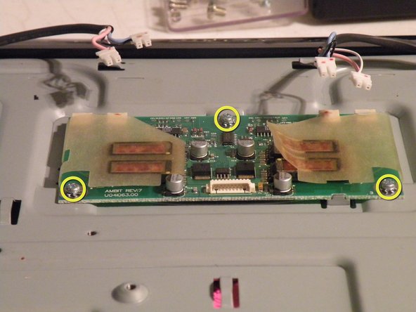

    • Removing the backlight inverter:
    • Remove these 4 connectors, it is important to remember their order!
    • Remove these 3 phillips screws.

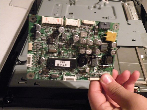

    • Removing the logic board:
    • Remove these two connectors.
    • This one too!
  12. Apple Studio Display M7649 Teardown: crwdns2935265:012crwdnd2935265:01crwdnd2935265:02crwdne2935265:0 Apple Studio Display M7649 Teardown: crwdns2935265:012crwdnd2935265:02crwdnd2935265:02crwdne2935265:0
    • Remove these 4 phillips screws.
    • This connector isn't used, it is left disconnected, I am assuming that it is to test the display for Apple.
    • Lift the logic board out if the case and set it aside.

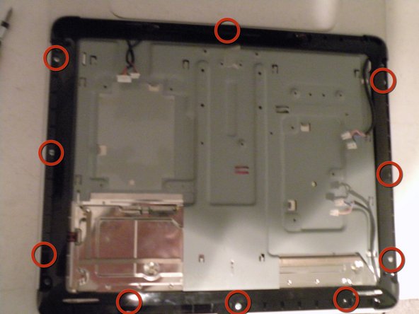

    • Removing the inner rim and button assembly:
    • Using a flathead screwdriver, or spudger, remove the 4 pieces of plastic around the black frame.
    • This will reveal numerous phillips screws.
    • Remove them all.
  14. Apple Studio Display M7649 Teardown: crwdns2935265:014crwdnd2935265:01crwdnd2935265:02crwdne2935265:0 Apple Studio Display M7649 Teardown: crwdns2935265:014crwdnd2935265:02crwdnd2935265:02crwdne2935265:0
    • Once all of the screws are removed, lift the rim out.

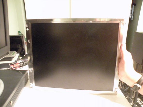

    • Removing the LCD Panel
    • Remove all of these screws from the metal frame.
  16. Apple Studio Display M7649 Teardown: crwdns2935265:016crwdnd2935265:01crwdnd2935265:01crwdne2935265:0
    • And, all of these:

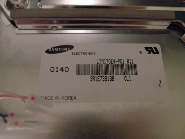

  17. Apple Studio Display M7649 Teardown: crwdns2935265:017crwdnd2935265:01crwdnd2935265:03crwdne2935265:0 Apple Studio Display M7649 Teardown: crwdns2935265:017crwdnd2935265:02crwdnd2935265:03crwdne2935265:0 Apple Studio Display M7649 Teardown: crwdns2935265:017crwdnd2935265:03crwdnd2935265:03crwdne2935265:0
    • Once you have removed all of the screws, remove the rear metal panel, watching the inverter cables of course!, this will provide acess to the LCD Panel
    • The Panel is manufactured by Samsung, and aparerntly, aren't easy to find, I Googled the model # and found 2 results.
    • Well, that's it for this teardown, good luck!
