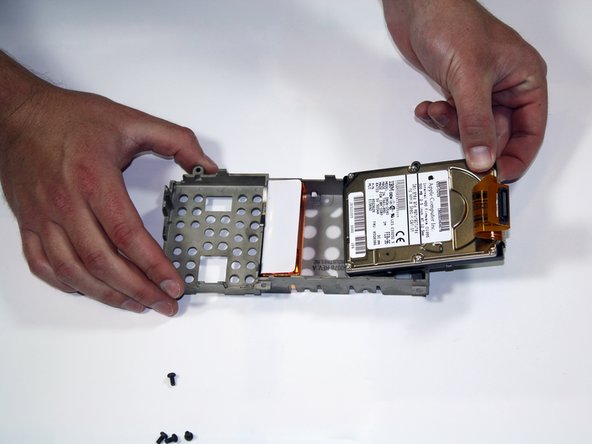

    3. Apple Powerbook 5300 Hard Drive Replacement: crwdns2935265:06crwdnd2935265:01crwdnd2935265:02crwdne2935265:0 Apple Powerbook 5300 Hard Drive Replacement: crwdns2935265:06crwdnd2935265:02crwdnd2935265:02crwdne2935265:0
      • Unscrew the four Torx #8 screws holding the hard drive to its case.
      • The hard drive can now be removed from its encasement.
