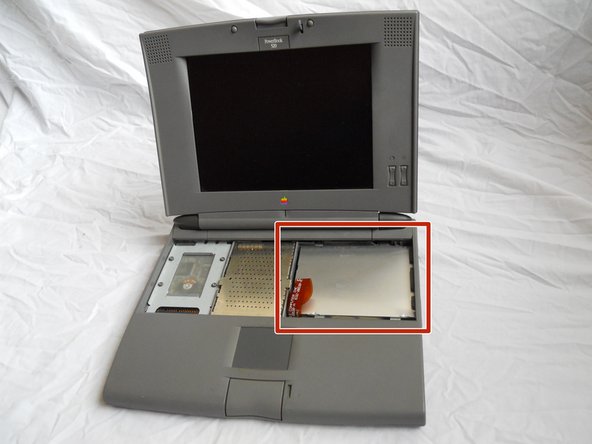

    • Turn computer over.
    • Remove battery expansion cover and battery.

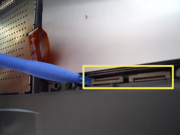

  7. Apple Powerbook 520/540 General Disassembly: crwdns2935265:07crwdnd2935265:01crwdnd2935265:03crwdne2935265:0 Apple Powerbook 520/540 General Disassembly: crwdns2935265:07crwdnd2935265:02crwdnd2935265:03crwdne2935265:0 Apple Powerbook 520/540 General Disassembly: crwdns2935265:07crwdnd2935265:03crwdnd2935265:03crwdne2935265:0
    • Lift the white ribbon clamps securing the keyboard ribbon cables to the motherboard. You can do this using a plastic opening tool.
    • Removing both ribbon cables from the motherboard will leave the clamps like so.
    • From here you can access the logic board, hard drive, and floppy drive.
