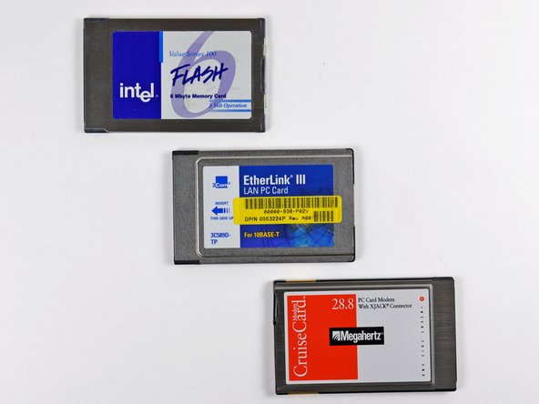

    • The Newton also interfaces with PC cards through its two internal slots. This allows the use of LAN and external memory cards concurrently.

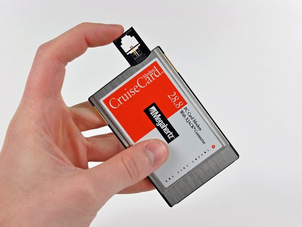

  4. Apple Newton MessagePad 2000 Teardown: crwdns2935265:04crwdnd2935265:01crwdnd2935265:02crwdne2935265:0 Apple Newton MessagePad 2000 Teardown: crwdns2935265:04crwdnd2935265:02crwdnd2935265:02crwdne2935265:0
    • Imagine the joy in our hearts when we discovered this nifty PCMCIA Modem card with an XJACK connector.
    • Granted this is not included with the MessagePad 2000, however we were blown away by the awesome pop-out RJ-11 socket.

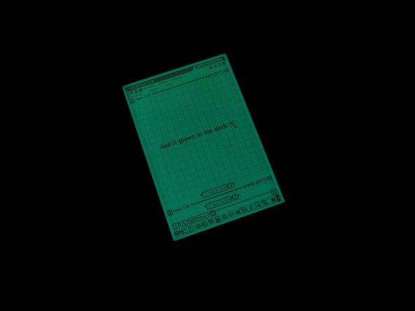

    • The awesomely '90s monochromatic backlight helps illuminate the Newton in low-light situations.

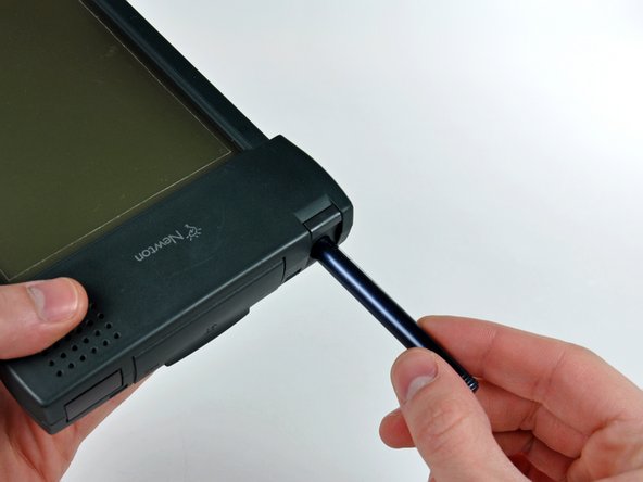

  7. Apple Newton MessagePad 2000 Teardown: crwdns2935265:07crwdnd2935265:01crwdnd2935265:02crwdne2935265:0 Apple Newton MessagePad 2000 Teardown: crwdns2935265:07crwdnd2935265:02crwdnd2935265:02crwdne2935265:0
    • Open the battery compartment by pulling on the small release lever and pull the battery compartment straight away from the outer case.
    • The MessagePad 2000 requires four AA (LR6) alkaline batteries.
    • Pull the stylus capacitive pen away from its recess in the case.

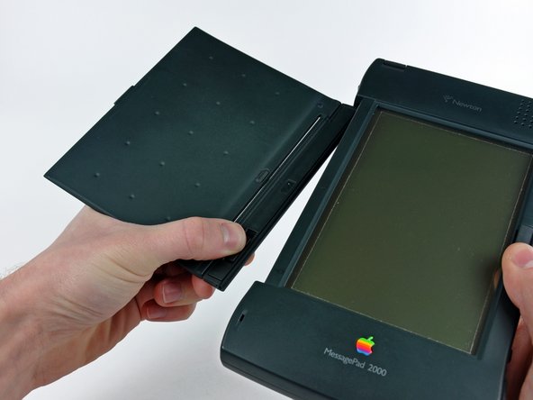

  8. Apple Newton MessagePad 2000 Teardown: crwdns2935265:08crwdnd2935265:01crwdnd2935265:02crwdne2935265:0 Apple Newton MessagePad 2000 Teardown: crwdns2935265:08crwdnd2935265:02crwdnd2935265:02crwdne2935265:0
    • Push the sliding tab attached to the inner hinge of the display cover toward the top of the Newton.
    • Pull the bottom edge of the display cover away from the outer case and remove it from the Newton.

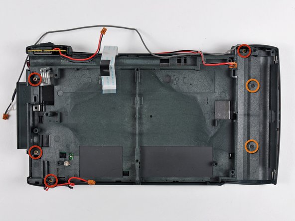

  9. Apple Newton MessagePad 2000 Teardown: crwdns2935265:09crwdnd2935265:01crwdnd2935265:02crwdne2935265:0 Apple Newton MessagePad 2000 Teardown: crwdns2935265:09crwdnd2935265:02crwdnd2935265:02crwdne2935265:0
    • Remove the four 12 mm Phillips screws securing the rear case to the Newton.
    • In the next step you will remove the rear case which is attached to the Newton by several clips around its perimeter. The location of the clips is shown in the second picture.

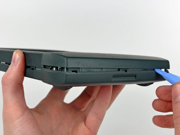

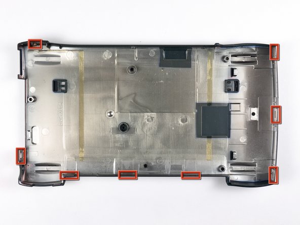

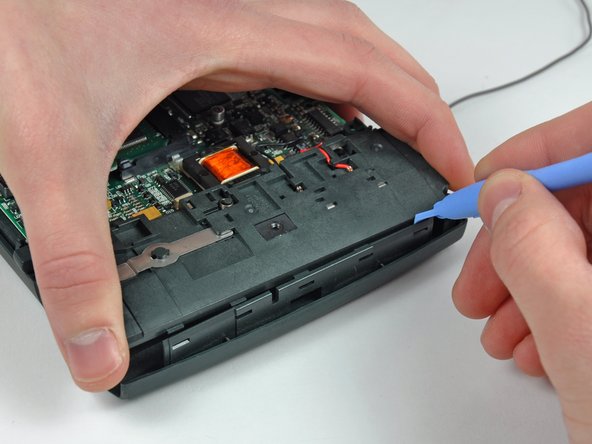

  10. Apple Newton MessagePad 2000 Teardown: crwdns2935265:010crwdnd2935265:01crwdnd2935265:02crwdne2935265:0 Apple Newton MessagePad 2000 Teardown: crwdns2935265:010crwdnd2935265:02crwdnd2935265:02crwdne2935265:0
    • Beginning with the seam where the display cover used to be attached, use a plastic opening tool to release the three clips along the power button side of the Newton.
    • These clips are constructed of plastic, making them inherently delicate. To avoid breaking them, do not force the two components apart.
    • Continue prying along the left side of the Newton and proceed to free the clips along the Newton's lower edge.
  11. Apple Newton MessagePad 2000 Teardown: crwdns2935265:011crwdnd2935265:01crwdnd2935265:01crwdne2935265:0
    • Be sure the AC adapter/keyboard door is open before proceeding.
    • Use the edge of a plastic opening tool to pry the rear case away from the Newton near the stylus opening.

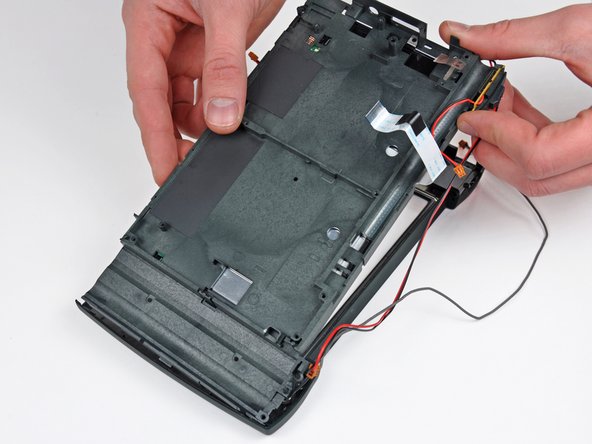

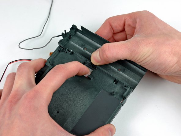

  12. Apple Newton MessagePad 2000 Teardown: crwdns2935265:012crwdnd2935265:01crwdnd2935265:02crwdne2935265:0 Apple Newton MessagePad 2000 Teardown: crwdns2935265:012crwdnd2935265:02crwdnd2935265:02crwdne2935265:0
    • After much (careful) wiggling and prying, the rear case lifts right off the Newton.

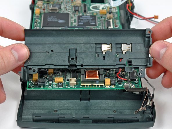

  13. Apple Newton MessagePad 2000 Teardown: crwdns2935265:013crwdnd2935265:01crwdnd2935265:02crwdne2935265:0 Apple Newton MessagePad 2000 Teardown: crwdns2935265:013crwdnd2935265:02crwdnd2935265:02crwdne2935265:0

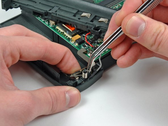

    • Before removing the stylus holder, disconnect the power button and backlight connectors from the logic board.
    • The connectors used on the Newton are very firmly seated in their sockets. To avoid shearing the socket off the board, work very slowly and use a combination of tweezers, the tip of a spudger, and your fingernails to remove the connectors.

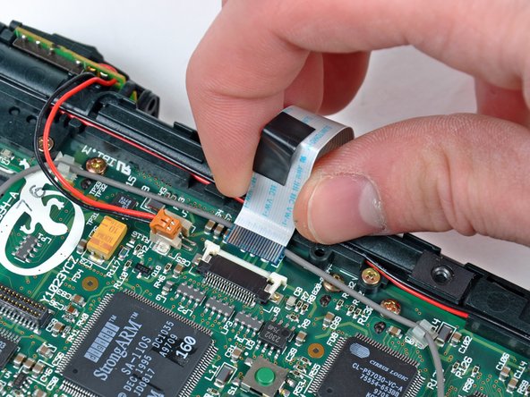

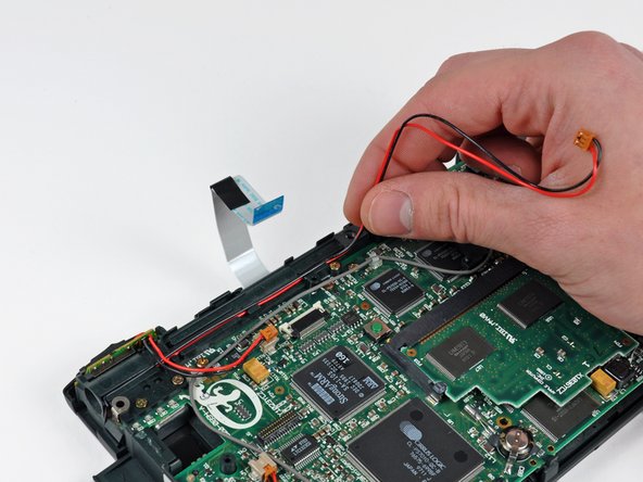

  14. Apple Newton MessagePad 2000 Teardown: crwdns2935265:014crwdnd2935265:01crwdnd2935265:03crwdne2935265:0 Apple Newton MessagePad 2000 Teardown: crwdns2935265:014crwdnd2935265:02crwdnd2935265:03crwdne2935265:0 Apple Newton MessagePad 2000 Teardown: crwdns2935265:014crwdnd2935265:03crwdnd2935265:03crwdne2935265:0
    • Use your thumbnails to slide the lock on the ZIF display data cable socket toward the edge of the Newton.
    • The lock will move about 2 mm and stop. Do not try to completely remove the display data cable lock.
    • Pull the display data cable out of its socket.
    • De-route the display backlight cables from the channel in the black plastic stylus holder.

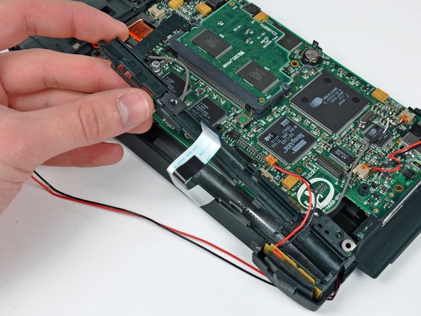

  15. Apple Newton MessagePad 2000 Teardown: crwdns2935265:015crwdnd2935265:01crwdnd2935265:02crwdne2935265:0 Apple Newton MessagePad 2000 Teardown: crwdns2935265:015crwdnd2935265:02crwdnd2935265:02crwdne2935265:0
    • Remove the four 6.3 mm Phillips screws securing the black plastic stylus holder to the Newton.
    • Carefully lift the stylus holder out of the Newton.

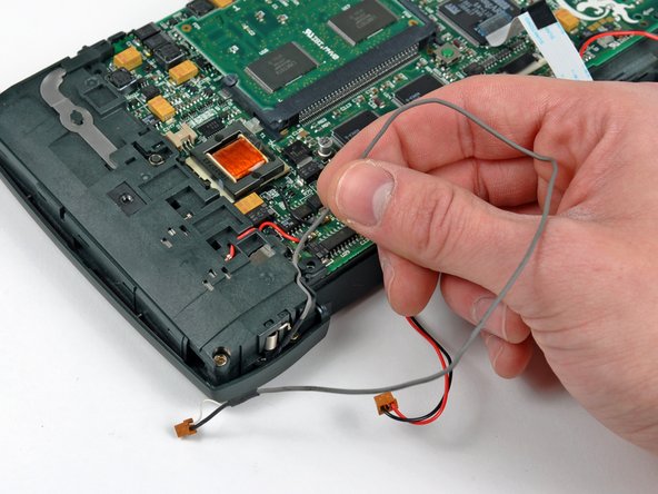

  16. Apple Newton MessagePad 2000 Teardown: crwdns2935265:016crwdnd2935265:01crwdnd2935265:03crwdne2935265:0 Apple Newton MessagePad 2000 Teardown: crwdns2935265:016crwdnd2935265:02crwdnd2935265:03crwdne2935265:0 Apple Newton MessagePad 2000 Teardown: crwdns2935265:016crwdnd2935265:03crwdnd2935265:03crwdne2935265:0
    • Disconnect the speaker and microphone cables, being careful not to break their sockets off the logic board.
    • De-route the speaker cable and move it away from the logic board.

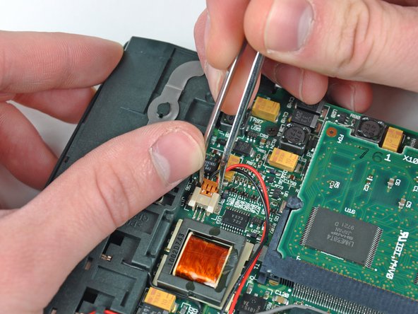

  17. Apple Newton MessagePad 2000 Teardown: crwdns2935265:017crwdnd2935265:01crwdnd2935265:03crwdne2935265:0 Apple Newton MessagePad 2000 Teardown: crwdns2935265:017crwdnd2935265:02crwdnd2935265:03crwdne2935265:0 Apple Newton MessagePad 2000 Teardown: crwdns2935265:017crwdnd2935265:03crwdnd2935265:03crwdne2935265:0
    • Remove the single 6.3 mm Phillips screw securing the upper half of the battery compartment to the Newton.
    • While lightly lifting the upper half of the battery compartment, use the edge of a plastic opening tool to release the five clips along its outer edge.
    • Lift the upper half of the battery compartment and gently lay it on the logic board.

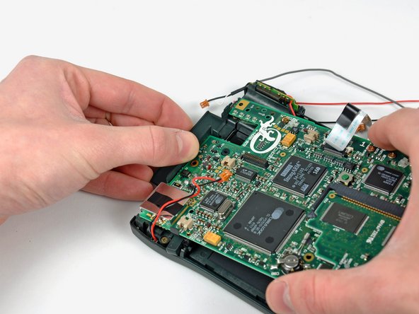

  18. Apple Newton MessagePad 2000 Teardown: crwdns2935265:018crwdnd2935265:01crwdnd2935265:02crwdne2935265:0 Apple Newton MessagePad 2000 Teardown: crwdns2935265:018crwdnd2935265:02crwdnd2935265:02crwdne2935265:0
    • Remove the two black 3 mm Phillips screws securing the logic board to the inner case.
    • While holding the ground arm stationary with one hand, use a pair of tweezers to lift the ground spring off its plastic post on the inner case.

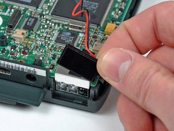

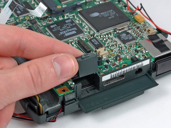

  19. Apple Newton MessagePad 2000 Teardown: crwdns2935265:019crwdnd2935265:01crwdnd2935265:03crwdne2935265:0 Apple Newton MessagePad 2000 Teardown: crwdns2935265:019crwdnd2935265:02crwdnd2935265:03crwdne2935265:0 Apple Newton MessagePad 2000 Teardown: crwdns2935265:019crwdnd2935265:03crwdnd2935265:03crwdne2935265:0
    • Before tilting the Newton around too much, remove the several small plastic pieces around its perimeter. These include:
    • The retaining clip near the stylus holder.
    • The small square blank cover under the AC adapter/keyboard connector flap.
    • The IR lens along the Newton's top edge.

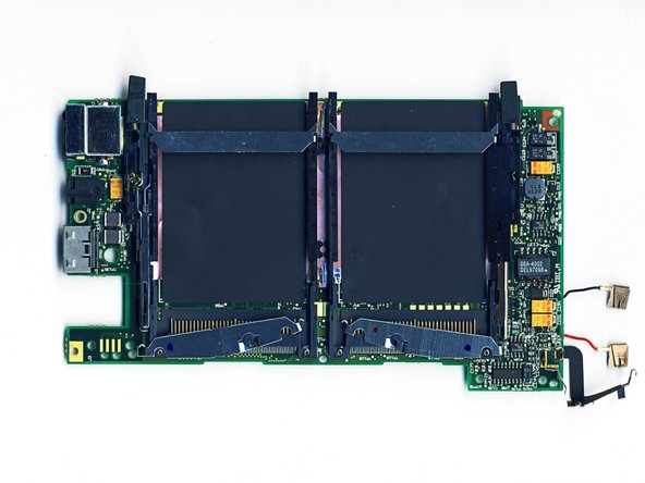

  20. Apple Newton MessagePad 2000 Teardown: crwdns2935265:020crwdnd2935265:01crwdnd2935265:02crwdne2935265:0 Apple Newton MessagePad 2000 Teardown: crwdns2935265:020crwdnd2935265:02crwdnd2935265:02crwdne2935265:0
    • Carefully pull the plastic retaining clip holding the logic board to the inner case near the ROM chip away from the center of the Newton.
    • Lift the logic board to separate it from the inner case.
  21. Apple Newton MessagePad 2000 Teardown: crwdns2935265:021crwdnd2935265:01crwdnd2935265:02crwdne2935265:0 Apple Newton MessagePad 2000 Teardown: crwdns2935265:021crwdnd2935265:02crwdnd2935265:02crwdne2935265:0
    • Carefully lift the logic board from its lower edge, making sure not to bend it in the process.
    • Pull the plastic cover away from the AC adapter/keyboard ports for enough clearance to remove the logic board.

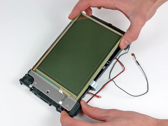

  23. Apple Newton MessagePad 2000 Teardown: crwdns2935265:023crwdnd2935265:01crwdnd2935265:03crwdne2935265:0 Apple Newton MessagePad 2000 Teardown: crwdns2935265:023crwdnd2935265:02crwdnd2935265:03crwdne2935265:0 Apple Newton MessagePad 2000 Teardown: crwdns2935265:023crwdnd2935265:03crwdnd2935265:03crwdne2935265:0
    • Remove the single 3 mm Phillips screw securing the front of the display to the inner case.
    • Flip the inner case over and use one hand to release the plastic retaining clip while pressing the display out of the inner case.
    • Lift the display out of the inner case, minding the fragile digitizer and display ribbon cables.

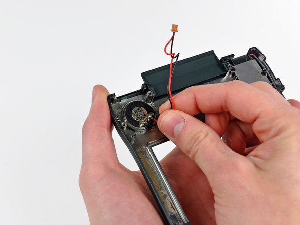

  24. Apple Newton MessagePad 2000 Teardown: crwdns2935265:024crwdnd2935265:01crwdnd2935265:02crwdne2935265:0 Apple Newton MessagePad 2000 Teardown: crwdns2935265:024crwdnd2935265:02crwdnd2935265:02crwdne2935265:0
    • Lift the microphone off its mounting pins on the inner case.
    • Remove the speaker from the front case.
    • The 20 mm 8 Ohm, .3 W speaker provides the Newton's mono sound.

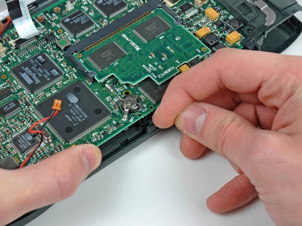

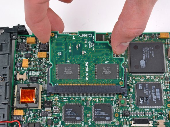

  25. Apple Newton MessagePad 2000 Teardown: crwdns2935265:025crwdnd2935265:01crwdnd2935265:02crwdne2935265:0 Apple Newton MessagePad 2000 Teardown: crwdns2935265:025crwdnd2935265:02crwdnd2935265:02crwdne2935265:0
    • Pull the two retaining arms away from the center of the ROM chip to release it from the logic board.
    • The ROM chip is spring loaded and should "pop" up once it is released.
    • Pull the ROM chip out of its socket on the logic board.

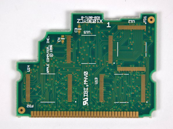

  26. Apple Newton MessagePad 2000 Teardown: crwdns2935265:026crwdnd2935265:01crwdnd2935265:02crwdne2935265:0 Apple Newton MessagePad 2000 Teardown: crwdns2935265:026crwdnd2935265:02crwdnd2935265:02crwdne2935265:0
    • Front and back pictures of the mask ROM board:
    • Two LHME5BT3 Sharp mask ROM chips.
    • Each chip is 4 MB of mask ROM, for a grand total of 8 MB of mask ROM! Shocking...we know...
    • The reverse of the mask ROM board looks to have space for four more chips.

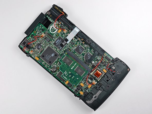

  27. Apple Newton MessagePad 2000 Teardown: crwdns2935265:027crwdnd2935265:01crwdnd2935265:02crwdne2935265:0 Apple Newton MessagePad 2000 Teardown: crwdns2935265:027crwdnd2935265:02crwdnd2935265:02crwdne2935265:0
    • Major players on the board include:
    • Two Sharp LH28F016SUT 2MB Flash ROM
    • DEC's 162 MHz StrongARM SA-110S 32 bit ARM Processor
    • Cirrus Logic's PS 7010/20/30 CPU Subsystem, Analog, and PCMCIA controllers, respectively
    • Hitachi's HM51W426OCLTT7 DRAM
    • Linear Technology's LTC1323 AppleTalk Transceiver
