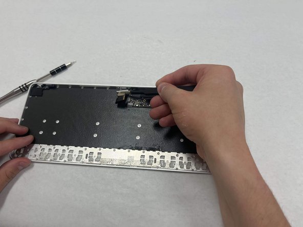

  2. Apple Magic Keyboard 2 A2450 Lightning Port Replacement, Lightning Port: crwdns2935265:02crwdnd2935265:01crwdnd2935265:03crwdne2935265:0 Apple Magic Keyboard 2 A2450 Lightning Port Replacement, Lightning Port: crwdns2935265:02crwdnd2935265:02crwdnd2935265:03crwdne2935265:0 Apple Magic Keyboard 2 A2450 Lightning Port Replacement, Lightning Port: crwdns2935265:02crwdnd2935265:03crwdnd2935265:03crwdne2935265:0
    • Use a T3 Torx screwdriver head to remove all twelve 5 mm that secure the midframe.
    • Use tweezers to disconnect the battery motherboard connection.
    • Remove the midframe.
  3. Apple Magic Keyboard 2 A2450 Lightning Port Replacement: crwdns2935265:03crwdnd2935265:01crwdnd2935265:03crwdne2935265:0 Apple Magic Keyboard 2 A2450 Lightning Port Replacement: crwdns2935265:03crwdnd2935265:02crwdnd2935265:03crwdne2935265:0 Apple Magic Keyboard 2 A2450 Lightning Port Replacement: crwdns2935265:03crwdnd2935265:03crwdnd2935265:03crwdne2935265:0
    • Use a T3 Torx screwdriver to remove the two 5 mm screws that secure the lightning port.
    • Use tweezers to remove the Lighting port from the motherboard.
