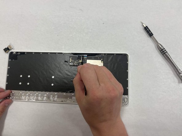

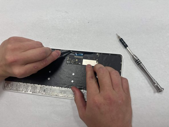

  4. Apple Magic Keyboard 2 A2450 Keyboard Replacement: crwdns2935265:04crwdnd2935265:01crwdnd2935265:03crwdne2935265:0 Apple Magic Keyboard 2 A2450 Keyboard Replacement: crwdns2935265:04crwdnd2935265:02crwdnd2935265:03crwdne2935265:0 Apple Magic Keyboard 2 A2450 Keyboard Replacement: crwdns2935265:04crwdnd2935265:03crwdnd2935265:03crwdne2935265:0
    • Use a T3 Torx screwdriver to remove the three 3 mm screws that secure the motherboard.
    • Remove the tape covering the ribbon cable on the top half of the motherboard.
    • Use a small pair of tweezers to gently unplug the ribbon cable and remove the motherboard from the keyboard.

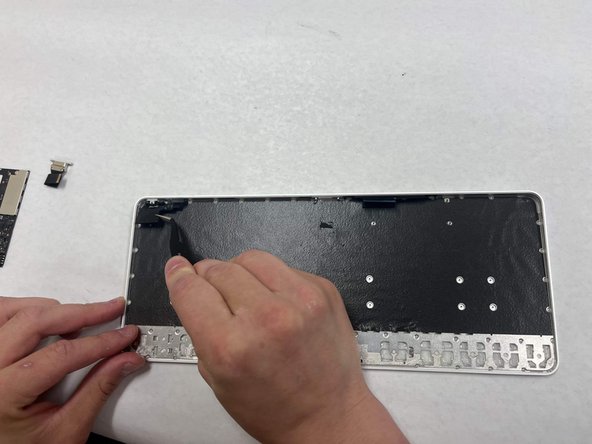

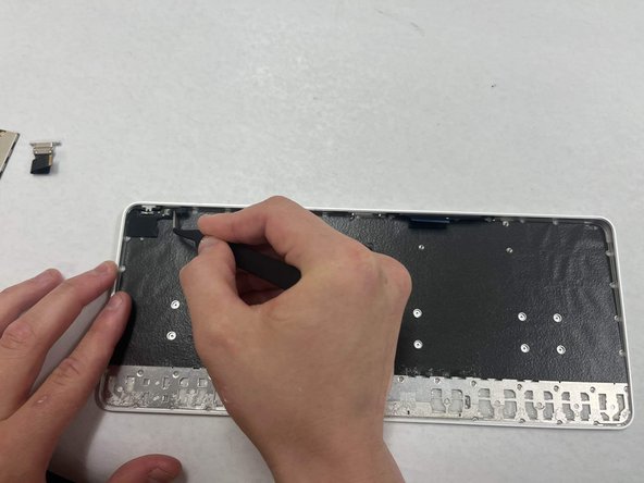

  5. Apple Magic Keyboard 2 A2450 Keyboard Replacement: crwdns2935265:05crwdnd2935265:01crwdnd2935265:03crwdne2935265:0 Apple Magic Keyboard 2 A2450 Keyboard Replacement: crwdns2935265:05crwdnd2935265:02crwdnd2935265:03crwdne2935265:0 Apple Magic Keyboard 2 A2450 Keyboard Replacement: crwdns2935265:05crwdnd2935265:03crwdnd2935265:03crwdne2935265:0
    • Use a T3 Torx screwdriver to remove the single 3 mm screw that secures the assembly to the frame.
    • Use tweezers to unplug the power switch from the case. Pull horizontally on the entire assembly to remove the switch from the keyboard.
